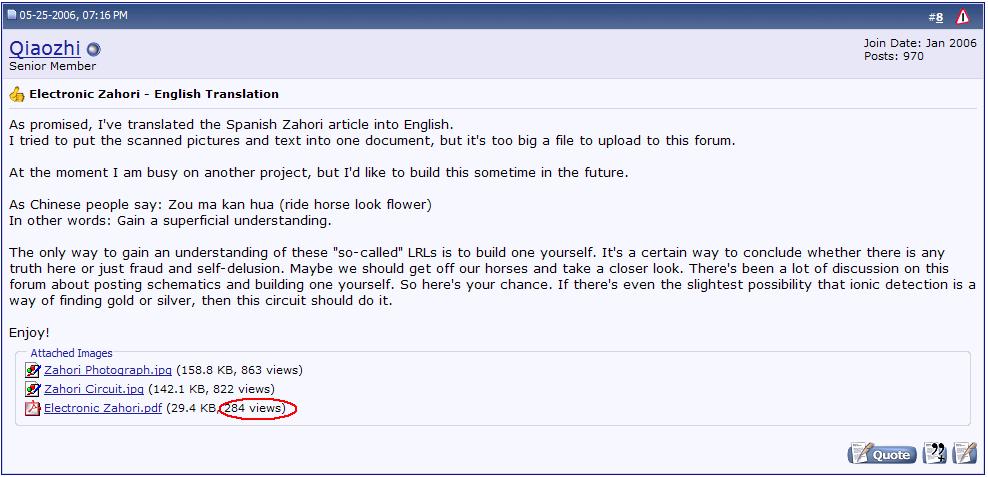

Old 08-29-2007, 09:33 PM
About text, translation by Qiaozhi has few readers. Near 600 in difference who looks images. Here:
Hi Esteban,
Yes, it is very strange. Why did so many people download the circuit, but not the description about how it works?

Hi Esteban,
Hi Qiaozhi,
No, isn't strange. Leave me an impression as many takes very light this. Remember, each day the people is more light!
Old 08-29-2007, 09:48 PM
Hi Esteban,
Hi Qiaozhi,
Actually I think the real reason is that most people are just collectors.
They see that someone has posted the Zahori, and they think "Oh goody, another schematic for my collection".
I still haven't built the Zahori, as I'm very busy doing other things, but I intend to get to it one day.
