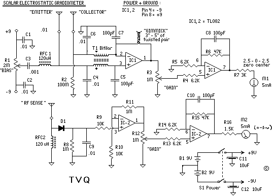

Default Scalar Electrostatic Gradiometer
Could this be modified and used in LRL?
I dont know. Just look interesting enough....
Esteban, what do you think?
Yes, you can try. In this field the only option is try and see response, but seems interesting. You have here 2 gains pots. Maybe is better preadjust alls with presets and leave in well compromise/stability. But you can't see small variations with the microamps, you need output beeps generator. When you find a device very sensitive wich movements on air don't produce falses, but detect old buried good conductive metals, well you're right.

I've been visiting the site above for more than 12 years. It's amazing how only now you discovered it. Maybe you'll know my secrets?
By the way the gradiometer was covered here already as gold sensor.
Some posts right bellow yours.
http://thunting.com/geotech/forums/s...ad.php?t=14363
Enjoy.
It is not amazing and it is not strange. So far i focused only on conventional metal detectors. Recently i decided to pay a bit more attention on magnetometers and gradiometers technology. Searching the internet i just founded it.
It is sort of differential amplifier. Yes it is gonna work and detect some differences in static potentials. Yet i dont see connection between that and detecting burried metals!? Not clear to me yet...
Ok....each step at the time....
I just dont want to see same behavior as with Zahori.
Will discuss this more in future...

"..Yes, you can try. In this field the only option is try and see response, but seems interesting. You have here 2 gains pots. Maybe is better preadjust alls with presets and leave in well compromise/stability. But you can't see small variations with the microamps, you need output beeps generator. When you find a device very sensitive wich movements on air don't produce falses, but detect old buried good conductive metals, well you're right..."
"Beep generator" is not a problem to add. That one from Zahori could also be used here...

I started to think different way here....pretty experimental design is in progress. I can only post part of schematic... Not completed yet.
Main idea is to use cylindric coils (simillar to FGM..) and adjust those in proper axis. Hold it low to soil surface and observe soil static changes (simillar, yet not the same as magnetometer)....
This is only "wild" experiment, not made and tested yet.
So...here is part of schematic already done...
I prefer pass the output of preamp to beep gen. stage with not polarized capacitors for to blocking DC. The detection occurs by a kind of impulse (as AC), so for this purpose you need blocking some small residual DC voltage.
