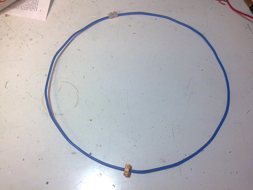

Rigid cable and 1 turn copper foil.

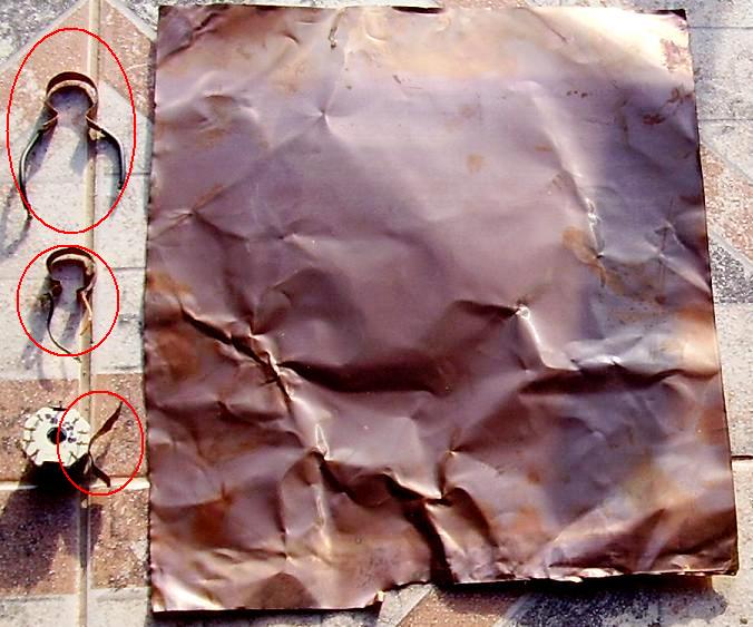

Old 06-28-2009, 07:47 PM
Here a copper foil and some foils made. One is inside the core.
