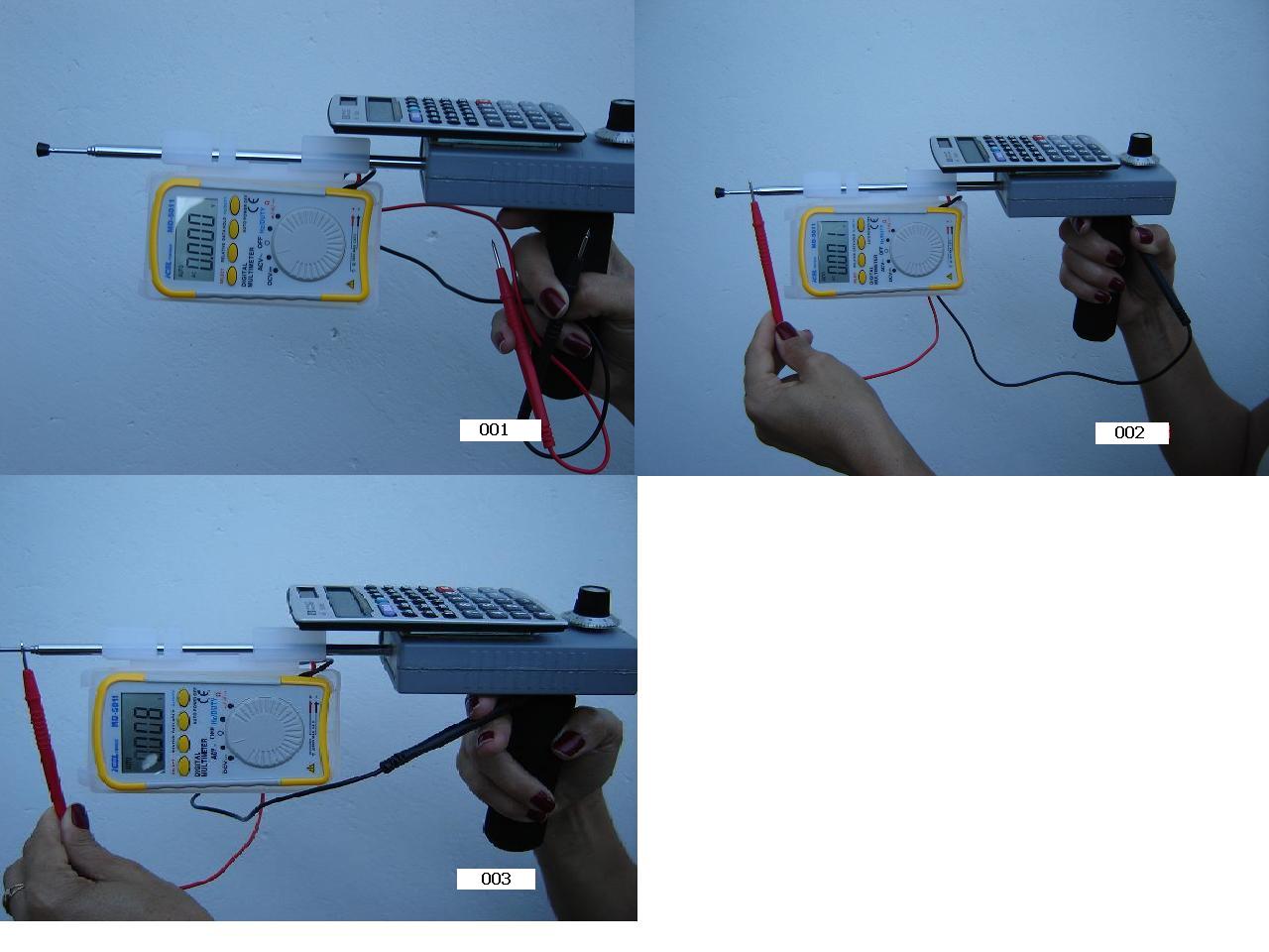

The way I was measuring the variances, was opening the examiner box and placing the positive probe in the lead of the diode which is connected to the pot. This however proved awkward to perform, specially because I had the top lid with the calculator falling to the sides risking to break the tiny wires soldered inside the circuit and also for dificulty of maneuvering for a photo session.
RT claimed to have measured the voltages without the need of opening the box. Simply connecting the positive lead to the handle and the negative to the antenna tip would suffice. I checked that and confirmed no perceivable differences existed, so I decided to use this aproach for this intent.
The initial series of pics show my wife holding the examiner. On pic#1, probes unconected and multimeter display with minimum activity, in this case, 0.000mv.
Pic#2, with calculator display on zero. Notice the low value reading on the multimeter. In fact as the 4 digit multimeter is very sensitive, it keeps changing values all the time. This makes it hard to document it in pictures, as I would have to use a very fast camera to shoot all these peak variations which would be completely unpractical. So I chose to shoot peaks according to parameters. So on 3, with calculator on gold’s frequency, notice the relative voltage rise. The display kept changing with up variations peaking at 8 (shown) with average on 5 to 6. No contact from her hand to any probe lead.

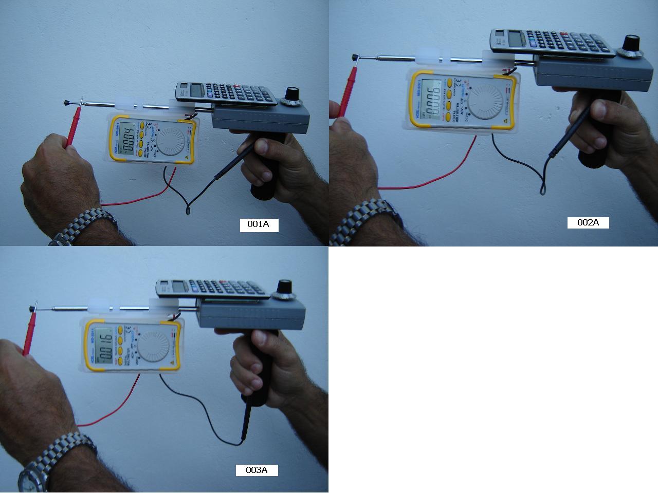

Next set of pictures shows another person holding the device. I confirmed that different persons holding it, might get different voltage values. On 3A, notice how the voltages are clearly higher when the negative lead gets a contact from the user’s hand.
This might explain why users of the examiner get different performances and why when they are ill, results are poor. I myself already noticed real poor detection results at night, specially if real tired.
*For those who thinks the hand contact might have accounted for this rise alone, simply get a multimeter and hold both probes with both hands. You’ll see a complete voltage decrease until display shows zero volts.
On 1A, calculator in ‘zero’ (voltages increased a little in respect to my wife’s turn). On 2A, gold frequency input and voltage rising.
Worth of mentioning that the examiner in the pictures is pointed towards a ‘supposed’ gold target.
I say supposed because when I hit a gold frequency and set the knob in a particular value, it points in thte direction showed.

I've took a look around these pictures... and only thing I see is that seems exist some kind of relationship between the digits on solar calculator display and the voltage the multimeter measure.
But I think that's quite obvious ... and explaination could be done without using relativistic physics and space-time alterations (that I already know happen so frequent at those latitudes of Hung ).
Ok , lets explain:
you see the picture with 4 digits and 22.5mv ? ok the next is with 6 digits and a reading of 43.1mV right ?
Now use some neurons from time to time... : with 4 digits -> 22.5 and with 6 digits -> 43.1 (that's about double of voltage).
Now what you see there ? If number of digits is higher you get higher voltage , yes or not ?
Now think at RT thing as at something with some hi-impeadance input amplifier connected to antenna set ... do you'll get a variation in voltage at inputs of amplifier if there is even a minimum circuit variation ??? Yes or not ?
Lets say there's some variation in circuit params that show as voltage variations at antenna... which could be ?
What's the purpose... but what's , most important, the effect of the solar calculator there ??? Doesn't it need current to work ? What about current needed to drive LCD display (that's realy few but that could lead to the difference you see on pictures) ?
So 4 digits 22.5mv... 6 digits 43.1 mv... and with 8 digits ? Maybe 85mV ??? What do you think ? Ok you have to use same multimeter to see that...
You read with sanwa multimeter 144.2mV and 6 digits... but think think think: it's not the same multimeter ! So there's some input impedance difference ... and what about light !?
Yes light ! It's a solar calculator man ! Light is important too... cause supply the calculator or not ? So if light change also readings must change ?
Enough ? For me yes. All that tests means nothing apart some small voltage variation at random segments on on display... what a discovery man.

From what I see in their pictures, there are several ways false signals could cause a voltage variation at the meter that have nothing to do with a target. In order to eliminate the possible voltage errors, here are some precautions that you could take to save yourself a lot of time contending with intermittent false readings:
Exactly. There is no mystery here, except in Hung's overactive imagination. If you take any digital multimeter, and set it to to a low mV range, there will be some low level intermittent readings if the leads are left dangling. After a short time the meter will settle at 0V, but even bringing your hands close to the meter leads will give a small reading. You will note that in all the images posted by Hung, that someone is physically making contact with the meter leads. The mysterious meter readings are nothing more than measurement error.

yes all right about errors in measures... but I was thinking at implications of having that calculator on the RT.... I mean it needs some current... lcd need the electric field to be generated... solar cells gives power according to light intensity etc etc all this stuff vary with time and other conditions (like showing 1 or more digit on the lcd screen that it's not only electric field problem there but also the logic part of circuit that drive it, so currents flowing in the chip etc etc).
Do you understand what I mean !? I'm not saying that he measured just errors by hands and the like BUT ALSO electric variations due to other components of RT (mainly calculator on top of it).
You see clear that when digits number increase you have rapid increase in readings in (supposed) same other conditions.
That's what I say: errors are due mainly to calculator cause RT has probably an hi-impedance amplifier connected to the antenna ... all the rest follow that thing ---> antenna and input path get an increase of signal due to interference of calculator circuitry.
So, I belive his readings are all true but there's a clear way of explain that without the device has to detect anything at all.
Maybe I've expressed bad my thought ?

Really? so you can't understand the meaning of using electronic methods instead of bogus experimenting? Let me translate it into a short statement that maybe you can understand more easily: It looks like you lied to us again about measuring voltage inside the Ranger Tell. You don't have a clue of how to use a voltmeter to make millivolt readings, as you followed the misinformation shown on the Ranger Tell page rather than showing us any readings you want us to believe you made inside the enclosure.
Max is correct. The calculator does produce small voltages.

You are correct. The calculator does use current to light up the digits in the LCD display. This is easy to measure on a calculator. Simply wind a small coil around a steel core using the same wire as you use to make a detector search coil. You can make this coil the size of a coin wrapped around a steel bolt, or up to the size of the calculator. Connect the ends to an oscilloscope and scan the calculator for magnetic components of a field. You will see the voltages inside the calculator, you will see some in the audio range that you could actually hear if you connected the coil ends to an audio amplifier. And you would also hear sounds change if you start to press buttons. You will find you can also measure some of the internal calculator operations with other odd tools instead of a coil. Maybe connecting the voltmeter to an old circuit board with some components on it placed near the calculator will give a reading, or a coat hanger wire with a transistor soldered to the end.
Inside the calculator
Whether the power comes from a battery or solar panel, a small amount is used to power each segment of the display as well as the processor and controllers in the main processor chip. While the statement that the calculator frequency varies is false, there are several fixed frequencies inside a calculator beginning with the main clock, and then lower frequencies used to drive the display and scan the keypad to detect buttons being pressed, and a few other functions. These frequencies don't change. If a number is entered into the calculator, the only change involves shift registers storing the numbers entered, and the display driver electronics sending impulses to the display segments. The frequency of the display driver does not change. Only the power sent to segments changes as different segments are switched on at this constant frequency.
Reading the rise and fall of these small switching circuits by using a coil outside the calculator is enhanced by a grid of keypad conductors which carry the low-frequency keypad scan strobe to a planar array that almost has the form of a kind of antenna printed on the circuit board. In addition, the voltage impulses sent to the LCD will show a pulse train with varying lengths and durations within the same frequency, in order to select which segments to light up. This pulse train is carried through a short ribbon cable usually. While these are the two most likely places to see a low frequency component perhaps in the audio range, there are other higher frequency components that happen only momentarily while the calculator is processing a user input or making a calculation. In the quiescent state, the only active circuits are the clock refreshing the memory, the keypad strobe, and the display driver. None of these frequencies change. But they can be measured on an oscilloscope or heard a sensitive audio amp.
How to promote bad science
Now if you wanted to use the voltage transients that are generated by a calculator to collect lots of money, or to prove some stupid concept of pseudoscience, first you would need to find a source of people who have little knowledge of the workings in a calculator, and don't have much experience using test equipment. Then direct them to use a millivolt meter in a way prone to electrical interference and use sloppy testing methods that are guaranteed to produce errors. This will make a good blend between the errors and calculator measurements. By using this technique, you may be able to convince a non-technical person that the calculator is finding gold, or that the readings prove you can extract free energy from a vacum. You might even convince him to send you a large sum of money to buy your calculator apparatus.
Think I am wrong? Think the Ranger Tell really does signal the presence of gold in the distance? Then try the experiment I described in the post above to remove the fake readings, and see for yourself.
Hi Max,
Have you looked at Carl's report on the RT Examiner? There is no hi-impedance amplifier inside the plastic case. There is just a jumbled collection of bits and pieces soldered together and hot glued in place.
If you place the leads of a digital multimeter close to a calculator, there is no pickup whatsoever, as long as you move away from these two items, and allow the readings to stabilize (to zero).
Well done J_P on an excellent description of what's really going on here.
There is definitely some electromagnetic interference (EMI) coming from the calculator, and this can indeed be detected by a small coil connected to an amplifier. However, this is not the case with the Examiner, which has been sadly totally misunderstood by Hung, unless (of course) you confer with the idea that the standard Maxwell-Heaviside model is erroneous because it omits the spin resonance.
