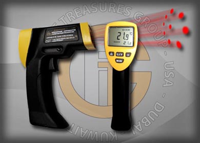

Hey, guess what? I just found that Knouzm has now a representative in Brazil.
I called and convinced him to go out to test the baby bellow which he sells.
http://knouzm.net/en/dis-300.html
I don't think I will have time to travel to another state just to do this , so I will contact one of my team members who live closer to know if he can do it.
I asked the representative to receive the manual in my email. Price is 'bitter' like any Knouzm.

Default More than you wanted to know about Infrared thermometers (Long Post Warning)
The "Laser Gun (DIS 300) device detecting for Gold, Treasures and Caves" is actually an infrared thermometer that appears to be an instrument manufactured by Oakton Instruments in Illinois, or a very close copy of one. Oakton's Infrapro line of infrared thermometers used a laser beam to indicate where the sensor was aimed at, along with a circle of 9 laser beams to define the limits of the spot where the temperature was being sampled. They discontinued this model and returned to a single laser beam to indicate where the sensor is pointed. The new models are the same as the old models, except for the 9 perimeter lasers were removed, and the center laser was changed to a brighter beam. Do you suppose these LRL vendors began selling surplus discontinued inventory at the same time Oakton and other manufactures stopped selling the old units with the "ring of laser beams"? Isnt Knouzm is now marketing a treasure sensing thermometer with a ring of 9 laser lights, with claims that there is a ".g" and a ".c" indicator that tells the presence of gold and caves?
I am familiar with infrared thermometers, as I have used them for years to make preliminary surveys in buildings for warm and cold areas in connection with locating sources of leaks and moisture intrusion. I can guarantee that Oakton Instruments never included any gold or cave sensors in their thermometers, nor did any other thermometer manufacturer that I know of. Yet these infrared thermometers could be useful in finding treasures under certain conditions. I have never used an infrared thermometer to try to locate treasure, but from my experience in locating framing behind walls, cold draft locations, and damp areas, I can see some possible uses in treasure hunting:
1. If a cave has a warm or cold draft exiting from its mouth, and the thermometer is within range, then you will see that the temperature is different than the surrounding areas. This does not guarantee you found a cave, but it is a temperature anomaly that could be a cave. It could also be a damp area of soil where ground water has come to the surface, or a number of other things that would cause a different temperature in that location.
2. If you are surveying an area closer than 50 meters, these thermometers could be used to search for warm and cool spots on the ground or hillside. A warm or cool spot does not equal treasure. It means only that a spot is warm or cool. If you find a spot that is warmer or cooler than the surrounding area, this could be for a number of reasons: In the hot sun, dark colored surfaces are usually warmer than light colored surfaces. Also, damp surfaces are usually cooler than dry surfaces.
The most likely way to find an anomaly under the surface is when the surface temperature changes. ie: Suppose the clouds move to cover an area that was in the hot sun for several hours. After maybe 10 minutes in the shade, the surface will start to lose it's heat. If there is some large object under the surface (or on the surface) that has a different specific heat than the surrounding surface, then it will lose heat at a different rate, and you will be able to sense it as a different temperature after the area has been cooling for a sufficient amount of time. This principle could also work to find a cold spot in an area that was shaded for a long time, and was suddenly exposed to the sun. The thermometer could also show areas that retained residual heat into the night after the surrounding areas cooled. Another use for infrared thermometers could be to follow cold drafts or trails of dampness to their source, if it was thought that this could help find a treasure.
How sensitive is the infrared thermometer? The models sold by knouzm and Kellyco will indicate 1/10 of a degree change. The absolute temperature can be calibrated if necessary, but This is of little use to the average treaure hunter on foot. The necessary temperature range in the field would be probably from -10C to 200C, but you would most likely find temperatures from 10C to 70C in normal use. Data logging features are of little use in the field unless you need to log a number of temperatures over a period of time, as in timed temperature changes as an engine heats up.
Do these thermometers detect buried gold? Not gold specifically. They could detect any metal or other substance that retains heat differently than the surrounding soil. This includes iron, copper, brass, silver, lead, water, wood, a hollow cavern, or practically anything different than the surrounding soil.
What do infrared thermometers really cost? It depends on what features you want. What is nice about these thermometers is that a very cheap model gives 0.1 degree resolution, and shows very subtle changes in temperature over a surface. I use a 0.1 degree resolution model for preliminary surveys before getting out the infrared cameras to make thermal images of a surface. You can buy a new infrared thermometer for $20 to $100 on ebay that has the same resolution as some of the $650 industrial models, but lacks the extra data-logging and other features.
Why do the industrial infrared thermometers cost up to $700 or more? Because they include a number of features that are expensive. Here are some of these extra features that raise the cost of an infrared thermometer:

The DIS-300 is actually a Mastech MS6530. It's highly, highly unlikely that the DIS-300 has any modifications, certainly not with the LCD. It's also impossible that their claims are true... buried gold absolutely cannot be distinguished from anything else based on temperature.
The evidence overwhelmingly suggests that this company sells treasure hunting scams. The fact that they also sell dowsing rod devices pretty much cements that conclusion.

Buried metal will quickly achieve temperature equilibrium with its environment.
Thought experiment.
Let us say for the moment, that there indeed is a bar of gold, buried
under the ground, that happens to have a temperature that is a few degrees higher than its surrounding. Forget how this could happen, let's just assume that it could.
Then, at the interface between the surface of the gold bar and the ground, we would expect that the material in contact with the gold bar will experience a temperature increase and come up to the same temperature as on the gold's surface. In the process of doing that, it pulled some heat out of the gold bar.
The other atoms in the ground close to the interface material, will have their temperature increased as well. Simply because if there is a temperature differential between them, heat energy will be transferred.
This process will continue and keep pulling heat energy out of the gold bar until the temperature of the gold is in equilibrium with the surrounding dirt.
So, after this process has happened you come with your electronic thermometer and what do you see? Nada!
I agree. My very expensive thermocamera isn't able to detect metals in the ground. Only if a big metalic object is in the ground 10..20cm then i can detect it only at the hours of day.

We in the USA cannot easily test the Mastech MS6530 because it is not made or sold in the USA. This thermometer is made in China. The only place it is obtained in the USA is through the Amazon.com seller who imports it from Hong Kong.
Mastech no longer lists the MS6530 in their catalog, as it has been replaced by the newer models. As near as I can tell, the remaining surplus stock of the obsolete Mastech MS6530 thermometers can be imported direct from the Hong Kong factory contact for low factory surplus prices if you need a lot of them. Scroll to the bottom of this page and contact Connie Keung for volume discounts:
http://pmastech.manufacturer.globals...hermometer.htm
The Knouzm company lied to us when they said it is made in the USA on their web page (DIS 300 feature #15): http://knouzm.net/en/dis-300.html
Knouzm lied about the place this thermometer was made just like they lied about the "13 Laser Waves considered as Ground Probes to measure", and just like they lied in their manual about adding two extra sensors for the treasure hunter. This is nothing but an obsolete Mastech Infrared thermometer that you can buy for about $100 or less from a Hong Kong importer. It cannot "discover from 20 Degree C to 527 Degree C for far distances and huge depths" as the web page states. It can only measure surface temperature. The Knouzm "Laser Gun (DIS 300)" cannot find treasure any better than an obsolete Mastech MA5630. Why would anyone pay $6000 for this cheap thermometer? Because the Knouzm company lied and made them believe it was modified so it can find treasure? Hahahahaha what kind of retarded idiot would believe that crap?
