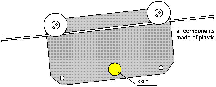

Geo, maybe WM6 will believe that your PD is neither OTD nor yet magnetometer if the PD stands still (without an operator nearby) and the coin moves alone without an assistant close by. For this purpose, must be stretched a rope with a slight tilt between two olive trees and to place on it a trolley with coin. A thread may be used to pull the trolley in opposite direction.
