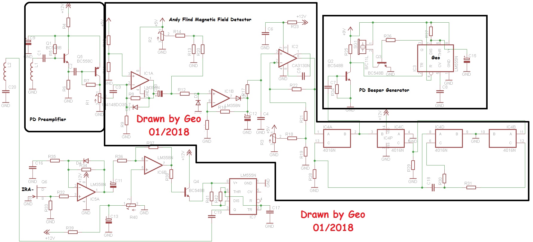

Some friends sent me schematics from Cryfton OBMD.
Schematics are not so clear so i will draw them with eagle and after it will attach here.
Because i have n't many free time it is more easy for me to give at the end a part list.
For the time the basic is to see the members what is happening with this lrl who cost so much money and is a mix of schematics from Andy Flind, Alonso's PD etc.
If i know will give info but will not criticize it.
I have n't so hight knowledge level.
I suppose that the schematic that i am working on is the OBMD-2 because the other one that i have is a little simpler...
If anyone has any comments, can write here...

Old 01-25-2018, 06:34 PM
Problem with upload.....................
will try again.
The file is 62k and when upload it it is 157 bytes....
Old 01-25-2018, 06:51 PM
Here is the schematic of Cryfton. I don't know if it is obmd1 or obmd2.
If anybody knows can inform here.
Next days i will complete the part list and will attach here.
Enjoy it

Old 01-25-2018, 07:18 PM
Join Date: Mar 2014
Posts: 1,050
Thank you Geo !
How to know the exact position of VR1 without the bargraph, unless there is a fixed value in the OBMD version ???

Old 01-26-2018, 06:27 AM
Thank you Geo !
No, you have the beeper....

Part list next week. My opinion is that the IR iss doing NOTHING so you can find the value from other parts at Andy Flind thread.

Old 01-26-2018, 06:17 PM
Also i have another schematic (maybe the first) where there are some differences at IR section, all the rest are the same (preamplifier + Andy's MFD).
I will redraw it later.....
Also i have and newer schematics......

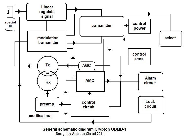

Old 01-26-2018, 06:51 PM
dragomir dragomir is offline
Join Date: Jan 2016
Posts: 80
Geo, this is the scheme of OBMD - 1
Old 01-26-2018, 07:41 PM
Thanks Dragomir.
So i have two versions of OBMD-1 and it miss me the OBMD-2.
Maybe a good friend to send it to me....

Dear friends!
This is the Schematic Diagram of Cripton OBMD-1.
Retrieved from the author's web site: http://crypton.com.gr
Sneshko

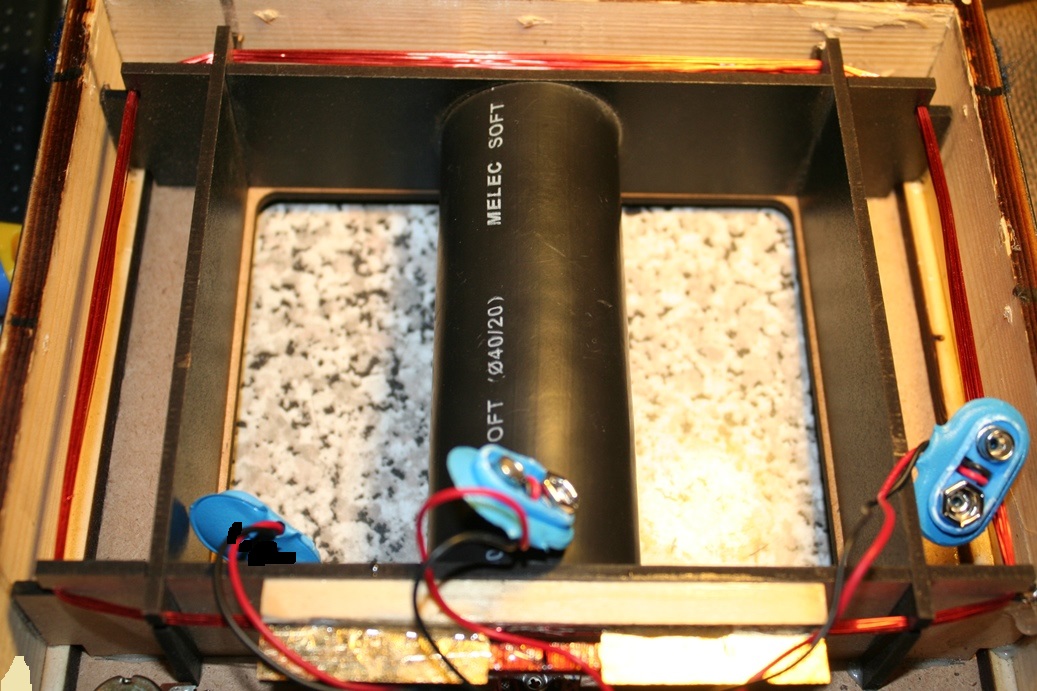

Old 01-27-2018, 06:59 PM
Hi Sneshko.
I post a photo from the coil of cryfton.
Do you see any circular coil or OO coils with critical null????
THere is only one square coil....

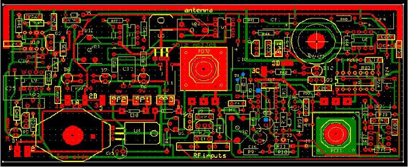

Hi Sneshko.
Ha, ha...! Very good Geo!
Thanks!
...Аnd, Is this PCB from OMBD-1 or 2 ???
Thank you in advance for the answer!
Sneshko
Old 01-28-2018, 06:40 AM
Originally Posted by dragomir View Post
Geo, is this an orginal device?
Yes, OBMD-1
Old 01-28-2018, 06:44 AM
Thank you Geo. what is its inductance ?
I don't know, not critical.
You wrap 30 turns and play with the capacitor
