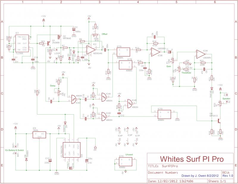

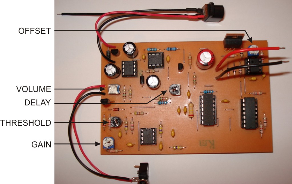

Old 05-28-2013, 02:38 PM
reza vir's Avatar
reza vir reza vir is offline
Join Date: Feb 2013
Location: iran-mazandaran
Posts: 345
Originally Posted by BENZINAS View Post
Is it possible someone to make me a long range iron detector with low cost and without big range and needs , i want to find some iron boxes covered with 30-40 cm of rocks in a place full of rocks , a simple detector just to show me were the boxes are when i pass next to them , detection only iron without discrimination , if anyone knows a detector-device in the market helping me do this job with rocks exept magnetometre ( too expensive ) with long range capability give me a link , opinions all accepted !
This circuit can help you
Old 05-28-2013, 04:25 PM
BENZINAS BENZINAS is offline
Join Date: Jun 2012
Location: GREECE
Posts: 133
what detector is this , vlf-pulse-lrl and how it works ?
