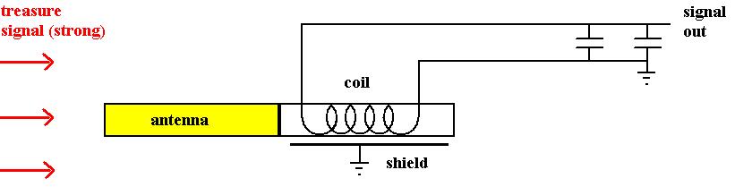

Absorption type. In the way.

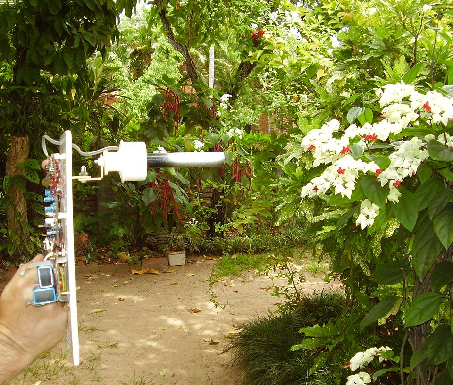

Finish and works great! Treasure can't scape of it! Is easy to mount in a plate (in this case, fiber glass), all are at hand. Radio is not use here, just amplificative stages.
Old 11-25-2008, 04:53 PM
Congratulation
You have very nice garden
.....Good Luck with your new pistol

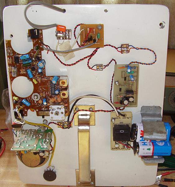

photo seems very seplice be built over the years you have successfully reduce everything to the minimum or e 'a new project

I recognise the construction modus operandi...lots of small PCB´s ,long-wired together...
Esteban, if you just need a very hight amplification factor, why you don´t use just an opamp, instead of all that stuff ??
regards,
Old 11-25-2008, 11:40 PM
regards,
I remember I explain that is ease this mode because no need to replace all PCB... So, in this mode I can make and select the good parts. When I found the better, I put in an only PCB. Here parts are: power supply, tune ferrite, pre, amp, audio. Yes, I have prepared a op-amp dual ferrite detector.

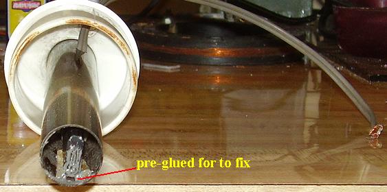

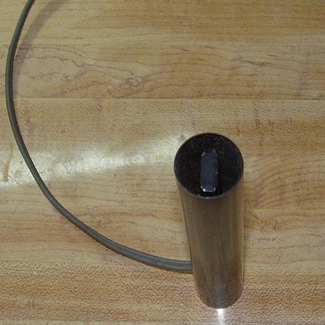

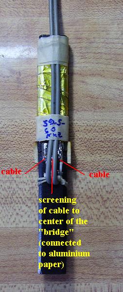

Hi Esteban.
The tube is plastic or metalic????
Also the shield has any gap ??

Hi Esteban.
Tube is used in fishing, fiber glass type. No gap, except extremes of ferrite free.

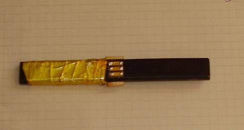

Ferrite:
Old 11-26-2008, 01:10 PM
Originally Posted by maimoune View Post
.....Good Luck new project.
congratulations
Thanks very much!
Old 11-26-2008, 01:13 PM
Two ferrites glued between them.

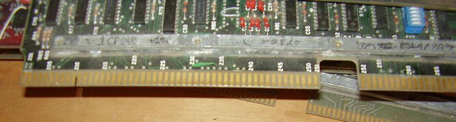

Old 11-26-2008, 01:26 PM
"Bridges" I cut of old equipment... gold coated. I have many useful "trash".

Hi Esteban, your ferite sensor which frequency accepts ?
(may be received 59,5khz - 60Khz )
