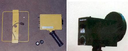

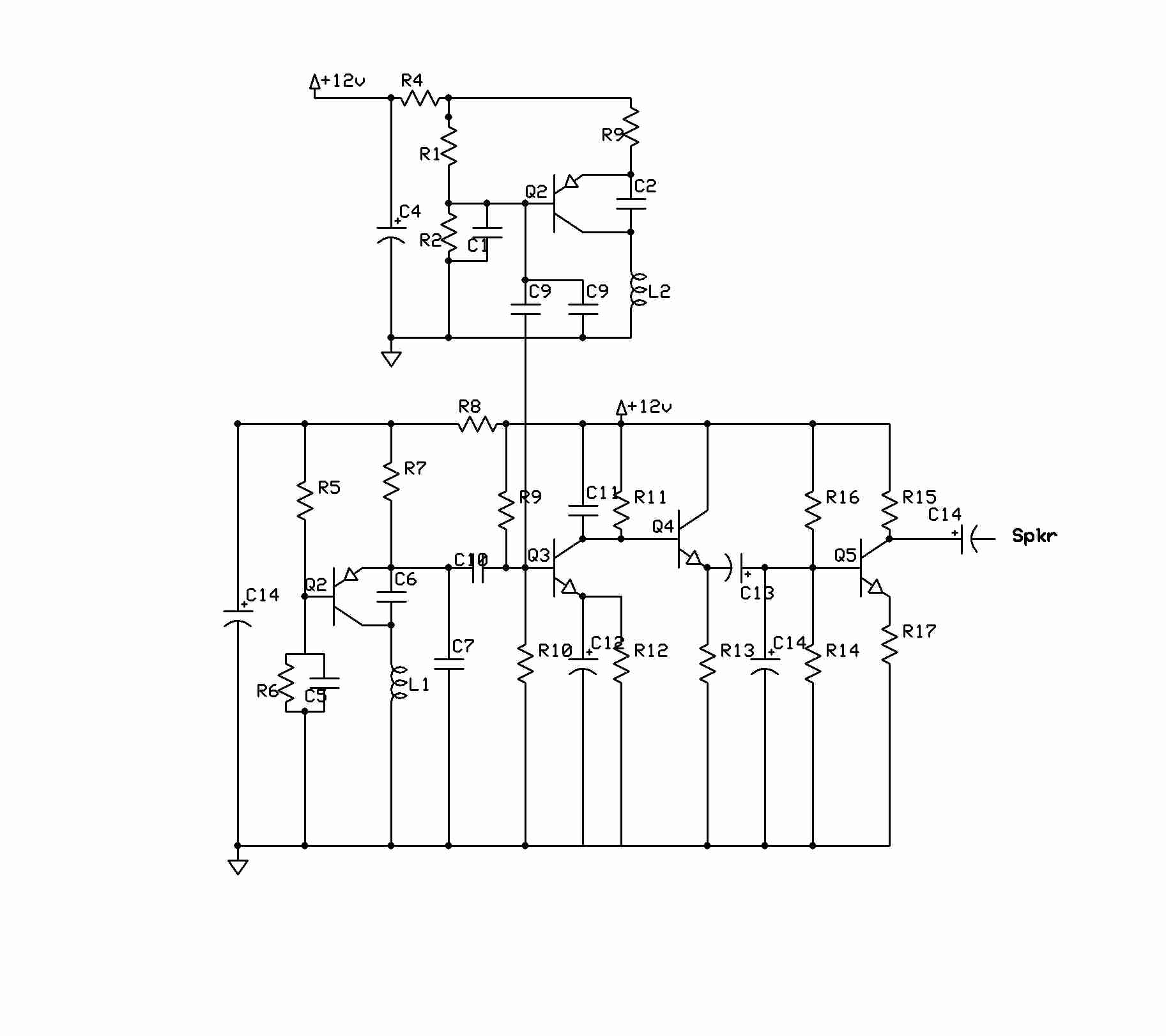

Here we can the LRL prototipe and another LRL yellow big Antenna device created by Alonso who still in TOP SECRET.
Old 10-08-2008, 12:51 PM

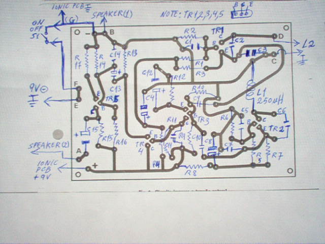

Default The B.F.Oscilator circuit
Attachment 6765
Attachment 6766

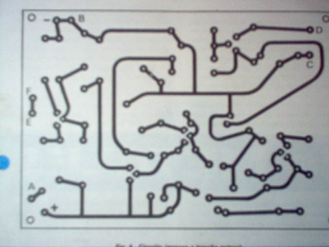

Name:  B.F.Oscilator corcuit schematic.JPG
Name:  B.F.O - PCB.JPG

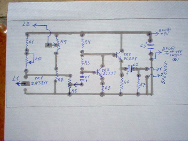

Name:  Ionic Electrostatic schematic.JPG

Hi, Morgan
L2=? uH
Two circuit ?
Old 10-09-2008, 09:02 PM

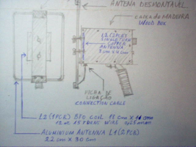

Default l2
Hi, Morgan
L2=? uH
Two circuit ?
the L2 in the ionic circuit its just one rectangular single turn copper antenna. its to put inside the wood box,behind the bfo coil.
Old 10-10-2008, 09:00 AM
I saw there's a 2N3819 there... very hi input impedance at gate...
I saw that stuff in some old e.g. power lines detectors: the hi impedance of fet make it easy getting signals from e.g. static charges (even if no current or really small flows in the wires or other conductors... and not only),
Now the problem is, how this kind of front-end couldn't be saturated by static charges all around... ?
I mean, also the user must e.g. walk... move... and electrostatic charging could appear due to clotes that move too over the skin etc
Doesn't it give a lot of false signals ?
Old 10-10-2008, 10:47 AM
Default LRL

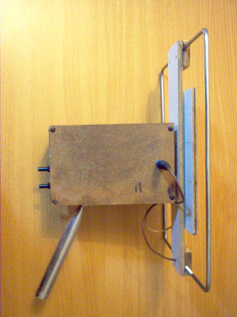

Hi Max
No false signals. You should not use nylon clotes.Device is so sensitive to microvolts,the screen of my TV detect 6meters,one ligth projector 4meters, of course power lines also and the phenomena of LTA buried metals.
The big problem here its the 250 mH RF chok,it drift time to time and needs adjustment with screw driver,and this is very boring to open the wood box to do it. If existe any Micro Henry control knob to put outside the wood box ,it will be great.Old BFO comes with Big 10 turn outside box capacitor ,but this not exist anymore.
This device works exactly as BFO detector,when its in the proximity of energy fields,we have reaction of the ionic circuit and increase in BF oscilator ,All together.
Possible to use device all the day,not become saturated if the ionic antennas are made as you can see in the photo.
In the begining of this project,we mix L2(ionic antenna) with BFO coil,and like this it becomes saturated,but if you put L2 as a square antenna direct behind BFO search coil,it works fantastic.
The BFO coil,should be made without any Faraday shield.
I dont know if this LRL works in Ireland a lot of umidity reduce the ionic electrostatic fields,so better you not spend time building another LRL p00p device.I dont want to see you again complaining...

thanks morgan for give this
hi brodhy, clear me one point
ibecause of instrucciones in circuit 1 are for my confuse
i not understand you say, where L1 circuit 1 oscillator
here say L1- 180x11 cm etc --------- AND down say 22cm x 30 cm, what is these?
clear me please
wire is inside aluminium tube square? is not easy put 15 turns inside
i am entusiast of bfo's not ufo's haha these complex stuff is for my
Old 10-10-2008, 03:49 PM
detectoman's Avatar
Posts: 935
mm i think understand
morgan say me ok
1.80 ( m ) es the messure lenght of aluminun tube extended for 1 cm of diameter ?
jjjjaajjaa hey brodhy these is of you wrong specification
Old 10-10-2008, 03:51 PM
detectoman's Avatar
Posts: 935
oh yeah i understand is the wire coper extended
but x 11 ( milesimas ) mm
fiuuuuuuuuuu
Old 10-10-2008, 08:35 PM
Here is schematic from your PCB.
NOT CHECKED!
It´s just a BFO detector.
Regards,
Old 10-10-2008, 11:42 PM
Default ???
NOT CHECKED!
Regards,
As i said before,its one BFO detector working together with one ion detector.You are missing the other PCB (ions detector).

Default Ionic Antennas & BFO Coil
clear me please
PCB1
L2= 18 cm x 11 cm BFO coil made of 12 or 15 turns,wire 0,25 mm. No Faraday Shield.
PCB2
L1= Big Aluminium Antenna 22 cm x 30 cm(ion detector 1)
L2=Small single turn,copper antenna 8cm x 4cm ,Ion detector 2(this one fixed in the wood box,behind the BFO coil).

Hi Morgan , L1 (PCB2) and L2 (PCB2) .
So open loop anten ?
Old 10-11-2008, 09:54 PM
Anyone going for Carl's gold yet.
I see circuits but no one is going for Carl's GOLD.
I will go back to lurking.
I have seen many post from you asking for diagrams to begin to build a LRL : now you have them...
Fred
Old 10-11-2008, 10:02 PM
Thumbs up The ionic circuit
This is Ionic Locator(negative). Yes we based on this one because its much more simple than Zahory,and it works very good.
The antennas we put diferent as you can see in my drawing,we get better results.
Yes realy very useful schematic...
