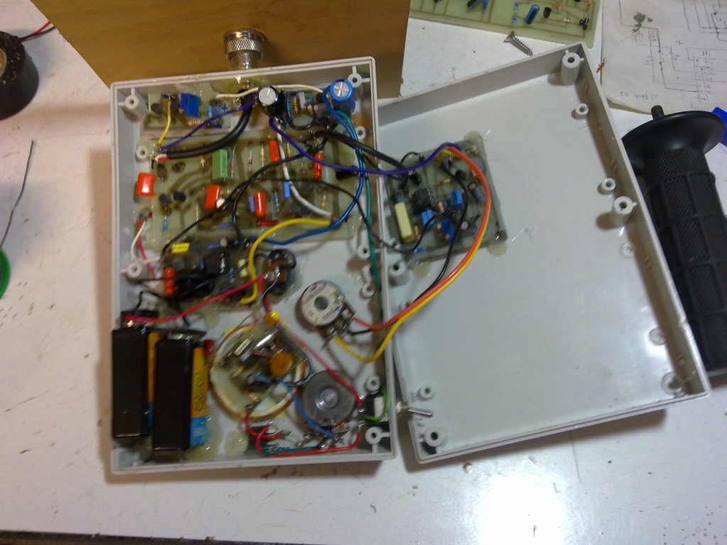

For this winter there are n't new projcts... i have construct a lot of lrls.
So i decided to modify some of them.
I started with the Andy's Flind MFD.
The main problem of this project is that it oscillates when buzer is near to coil and u try to give more sensitivity.
I found the solution and now i can give more... more gain, so i believe that its a super lrl.
Problem is that the weather is not good to try it. Later....
Also i connected a FM radio with TDA7000 so to have a "second" EMF detector.
Here photos...

Sorry but the last photo is npt a final photo...

good luck dear friend, may i know what are the components between the output of LM386 and NE555 ?
Old 12-18-2022, 09:14 AM
Posts: 3,946
clasic components as transistors... resistors etc. It is a clasic beeper by Esteban modificated a little by me.
Don't try to find a complete schematic, maybe will not work for you. Connect a signal generator and an osciloscope at your device and start the modifications. Instruments will give u all the info!!!!

Default PD with coil stimulator...
The second LRL that i will try to modify is a simple pd with coil stimulator. This lrl is the one that i had with me when i visited Morgan at Portugal (2009). At photo it has a different coil.
First modify is the connection of a 18650 li-ion battery in place of 2x 9V 9F22. Also an up converter is needed so to convert the 3.7v of 18650 to 12V.

also i plan to replace diodes 1N60... with other more sensitive....(rusian)

Hi Geo.maybe the operating frequency of the converter affect the reception? maybe it create interference.
I tried different diodes. The most that I personally liked in the work is the germanic d220 and the sensitivity increased and the stability of the receiver itself, if there are any, then try it. The d310 still doesn?t work badly, but it?s very difficult to find a pair for this series, they are made with a wide spread, maybe I came across such a batch.

Hi Pahom.
I don't remember the number of diodes now but i think that it is D9B. I tried them on a crystal radio and they had better sensitivity with more clear audio. There is big difference between them and 1N60 or IN914 or AA... that you find on ebay.
Hello Bill.
On second lrl (pd with coil stimulator) there is n't problem like this because i use external signal for coil stimulator.... from the other side the coil of the converter is shielded...
On first lrl (Andy's MFD) there is n't up converter...
ps.. How are the guys....

Hi Pahom.
Pahom.. i checked diodes, yes D9B.
I understood you. Previously, they were put by d9B a red stripe or two red stripes or red dots. Then he refused. Ask Kostas Russian d9b sent him something like that. If he didn?t spend them all.

Pcb at right is an equaliser (schematic by Esteban). I plan to deconect it because i did n't see it to doing something better
Also i plan to connect a potentiometer so to reduce the gain at places where there are strong magnetic fields, but i did n't decided how to do this.... by playing with the receiver pcb or by connecting a potentiometer in series with coil....

Good news, Geo!
Now i am ok... i have eagle's eyes...
Yesterday and today i visited my lab and finished the mod of PD. Results inside the lab are fantastic... it has at least twice and more sensitivity. If outside the lab be stable then will be a lrl near the top of all i have.

what are the other modifications Mr Geo ?
as i wrote at previous post i replaced in60 with d9b.
also i gave a little pore power at stimulator oscillator. i wanted to connect a one stage preamplifier on coil but sensitivity is so big.
frequency of Rx = 62khz and from stimulator 125khz
