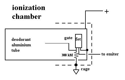

I have this schematic.

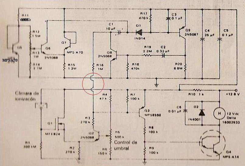

Old 12-06-2008, 04:57 PM
I translate the bad copy I have by this. Hope is OK. I presume the above part is a regulator. Here the clear:
Old 12-06-2008, 05:00 PM

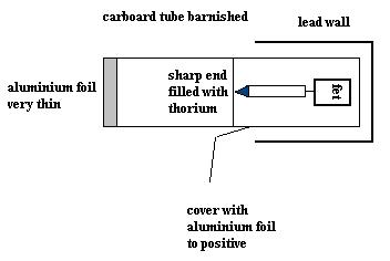

This can be the chamber.
Old 12-06-2008, 06:00 PM
The deodorant tube ??? NO!
You need a VERY thin wall to make radiations enter the chamber... so better is if you e.g. use a thin aluminium foil window in front side of the tube.
The rest you could made of any conductive material, but much better if the back side is shielded with lead 1mm walls. That way your chanber will be "directional" and (supposing it's useful) you could locate the source of radiations.
A good experiment is with lantern mantle (torium/radium doped) and old fluorescent tags (like old german ones...).
Old 12-06-2008, 06:39 PM
Hi Max
Thanks very much! Maybe this can be approximative...
Old 12-06-2008, 08:39 PM
As it's drawn, the circuit won't work... the +rail is shorted to ground. But if it did work, it would just be an electric field detector. Which could possibly detect the electric field from ions, but also any other electric field, leaving you with no way of knowing what you are detecting. And if it is due to ions, it tells you nothing about what kind of ions which, again, is rather useless.
Thin-walled chambers are used in radiation detectors, but detecting ions is not the same as detecting radiation. Remember that ions are atoms or molecules, not radiation, and can't pass through solid objects (like the Mineoro "ion chamber" ). A popular method of ion detection involves drift tubes, which must be open to allow ions to enter.

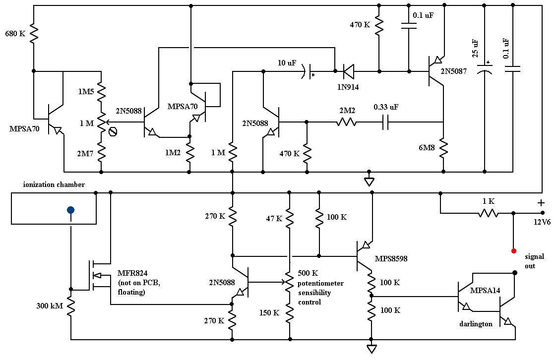

Old 12-07-2008, 06:20 PM
I think schematic should be like this:
Old 12-07-2008, 07:25 PM
I think you're right. Above part must be oscillator.

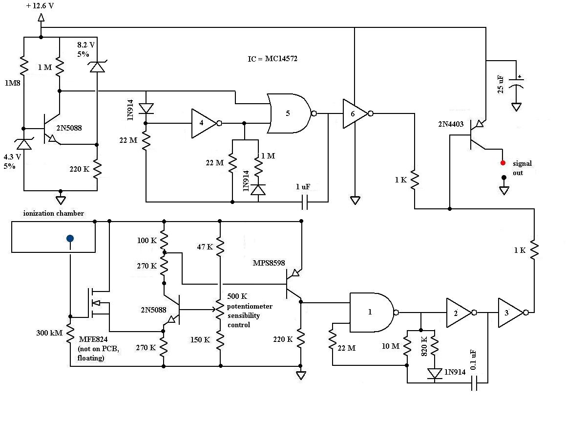

Old 12-07-2008, 09:33 PM
The same, but mos oscillator version. Copy of bad pic is the second image.
