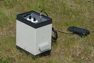

First I thought the ones they make feed the signal straight into the ground.Somebody else told me that you just put the aerial on the ground.This is how it looks in the photo anyway.Check the last line of the characteristics.Only 10 meters? Is it "maximal sphere of action" the effective range or something else?
Features of the Control Unit
Operating Temperature: 0 °C – 50 °C
Storage Temperature -20 °C – 60 °C
Air Humidity: 5 % – 75 %
Waterproof: No
Dimensions: 25H x 22W x 17D cm
Weight: about 7.4 kg
Frequency Range: 7 kHz - 60 kHz
Amplified Output Power: 10 W
Internal Battery: 24 V
Operating Time: (full charged battery) about 3 h
Charging Time: about 10 h
Maximal Sphere of Action: about 10 m
Old 02-20-2010, 02:22 PM
Yes, low effective antenna, nothing else. Maybe without such antenna only by resistive end you can reach the same "Sphere of action". Those antenna act only as TX output load to prevent Tx damage not as real and effective VLF/ULF antenna..
It is understandable that no one can build effective resonate antenna for wide Tx range of 7Khz to 60kHz. Practically impossible.
And why one need such wide frequency range? This is not working on VLF/IB or BFO principle where are some differences in detecting between frequencies. Here not, except partially in the immediate vicinity of target, but we are asking for some remote detecting. Here you need only one frequency say between 10-30kHz and resonate Tx and Rx antennas to selected frequency and as good as possible directivity of Rx antenna.
