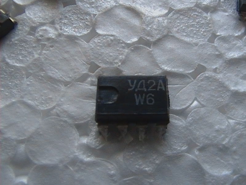

Here i m posting a picture of an integrated circuit, that replace CA3130, but i m not shure.
I need it to build zahori, so pleae if anyone know anything about this IC, please let me know.
In advance many thanks

Old 04-14-2011, 08:59 PM
This is UD2A (transcription from Russian) and can be replaced by CA3130 and vice versa of course.
You can replace by this IC LM324, LM224, , too.
Old 04-15-2011, 03:24 AM
How he can replace an LM324??? LM324 is a quad op.ampl.
Old 04-15-2011, 07:44 AM
Good noted Geo, thanks,
correction:
КР1401 (DIP14) УД2А (UD2A) = LM324, LM224
КР544 (DIP8) УД2А (UD2A) = CA3130
KP mean "korpus" (housing, package). Except different package we get both versions with the same type mark УД2А.
