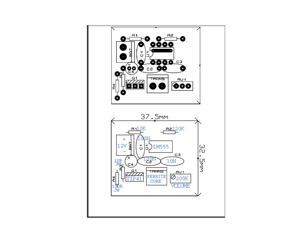

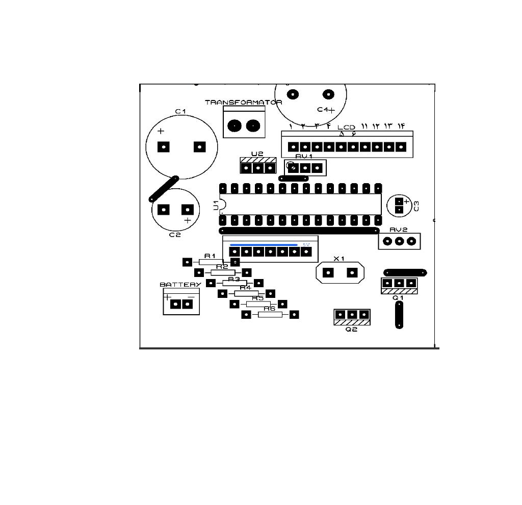

do you make this LRL my friend ??
i want make it but in new version small PCB change by Mr Tesla ( in Iranian forum ) so which is correct ?
see my means
http://felez-yab.com/showthread.php?tid=17
Old 05-12-2014, 05:49 PM
reza vir's Avatar
reza vir reza vir is offline
Join Date: Feb 2013
Location: iran-mazandaran
Posts: 345
Programming has not changed
The transmitter circuit is the same as the previous
Receiver circuit changes could
However, after resisting raising watts of warming prevented
ok
my friend i will make it just help me more for ( trans haye madare , amadash to bazar has? masalan begam 220 be 12volt ?? ya ... mishe bisgtar rahnamayi konin mamnoon ) . i do not the value of them
please help.

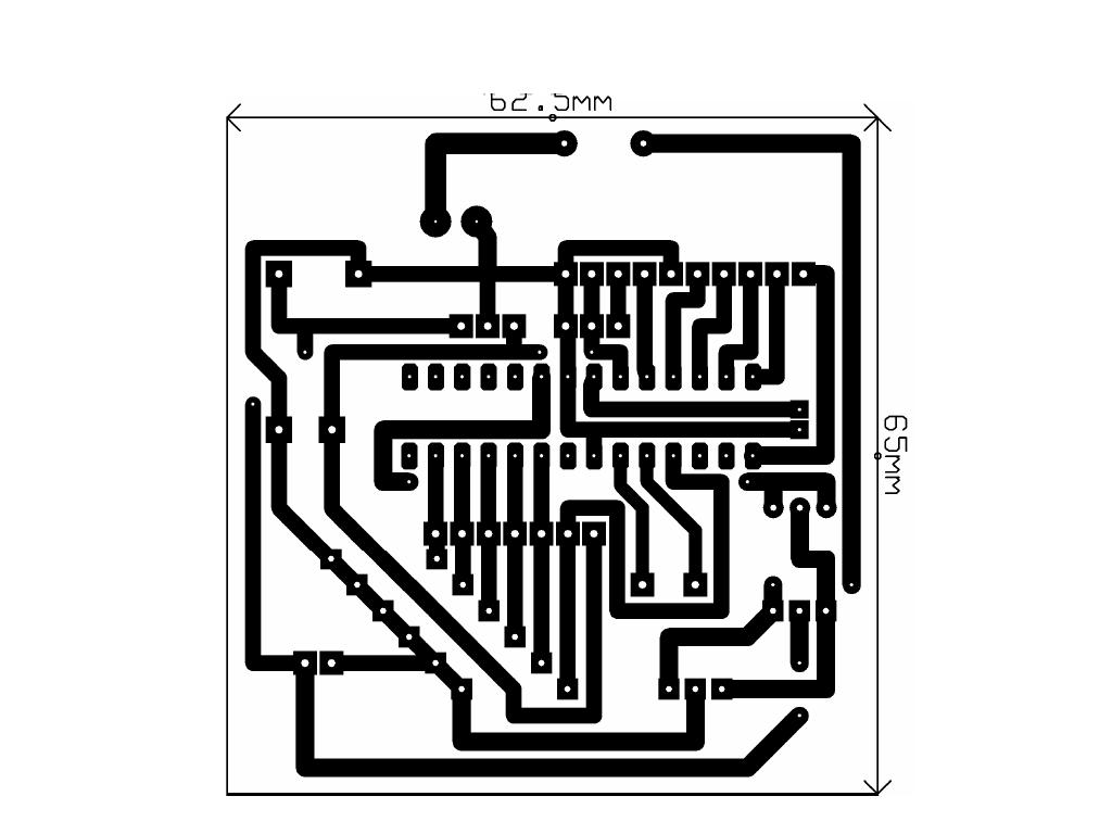

hi
i can help you to make it but i think have error , so what do you think ? do you see the pcb ?

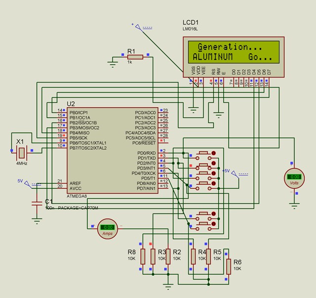

I have not complete data of this unit and know much of this but i try this Micro-Controller and seem it works..

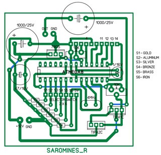

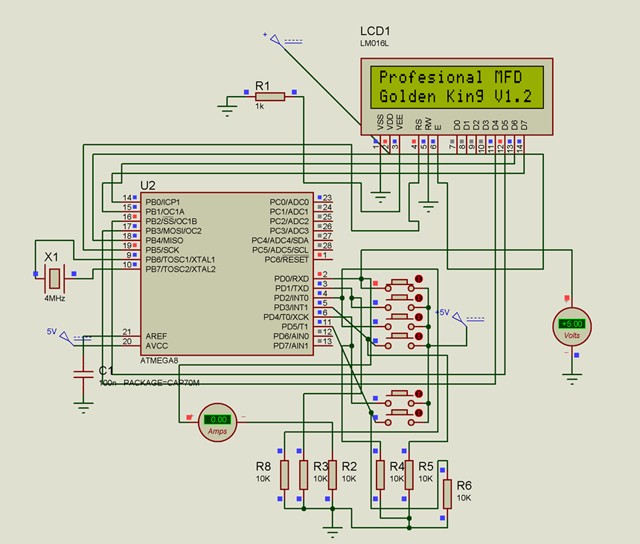

Iranian MFD

VERY NICE WORK AND MDF
TRY TO PUT THIS FREQUENCY
