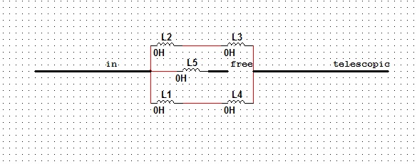

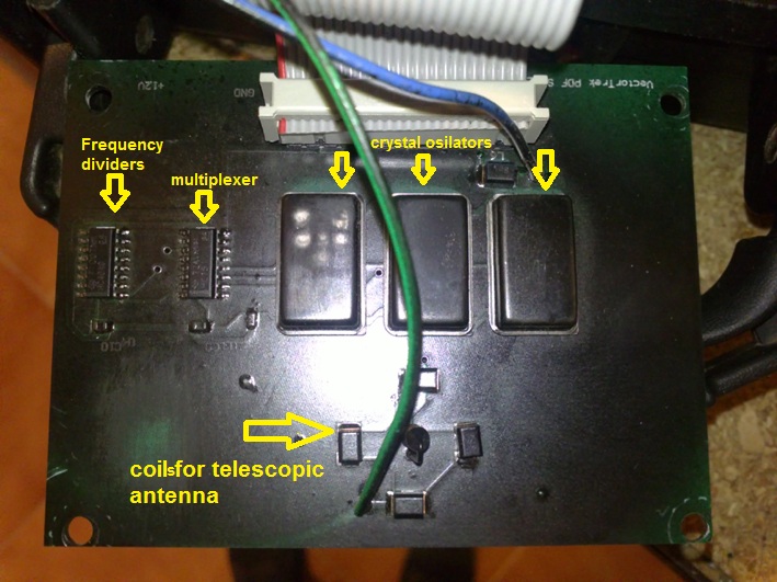

fitzgerald product are a big lie and expensive.I've prepared a product of Fitzgerald.pdf-1000
See all circuit in picture.Made up of 3 pieces crystal osilator 5 coils and 2 ic.
Output measured with osiloscop.
Signal amplitude was changed from 0 to 5v.target id is A key useless. Did not make any changes in the signal.telescopic antenna is a toy with frq (under vlf frq)
pdf-1000 is a toy no lrl

Old 01-10-2014, 05:25 PM
Posts: 2,124
What frequencies does he use?
Old 01-10-2014, 05:44 PM
mustefa ubram's Avatar
Join Date: Jun 2012
Location: Germany-Hanover
Posts: 320
100hz -150hz -200hz

was coil antenna :it is correct??????
Do you think it is practical?

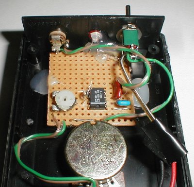

You don't need to be an EE to build an LRL.
Just some perboard, a 555 timer circuit copied from the datasheet, lots of hot glue, and a vivid imagination.

You know, I hate to call B.S. here but I really doubt those are Fitz's frequencies. Just looking a the advertisement, it says it is accurate to 1/10,000 of a Hertz. No way he would be using whole numbers, so something is not right here.

Yeah, that's right. You put it on an oscilloscope but you don't know.
Old 01-10-2014, 11:02 PM
Posts: 2,124
Maybe something is lost in translation here. You should be able to hook up a frequency counter or check the frequency with the oscilloscope. If you got 100Hz, 150Hz, 200Hz, I can tell you something must be wrong with the device.
It's called "not understanding what PPM means."

Yes, I now realize he was trying to copy the Vector Trek design and failed. I think the guy's name is Neil Pagal or something like that. It's definitely an older construction with the crystal oscillators. No, I have little electronics knowledge. If I get your take on the parts per million you're saying the accuracy cannot be that good especially if you start in the MHz range. I'm not ready to call them liars because I am not qualified.

So if you start with five parts per million that is one part per 200,000 and that is 1/1,000 at 200Hz. You'd have to get down to 20 Hz before you get 1/10,000 Hz accuracy. Since I don't know what freq they use, it is possible they get that accuracy. But that is assuming the freq divider is perfectly accurate. Not likely.
Old 01-11-2014, 07:09 PM
The PDF-1000 is a Vector Trek model made by Neil Pagal. Fitzgerald is just the peddler. I own a PDF-1000 but don't have the design details here in front of me.
The crystals are probably 100ppm which is pretty common. Someone who doesn't know what that means might claim an accuracy of 1/10,000 Hz but that only works if the output is 1 Hz. The "doesn't know what that means" only gets worse from there.
