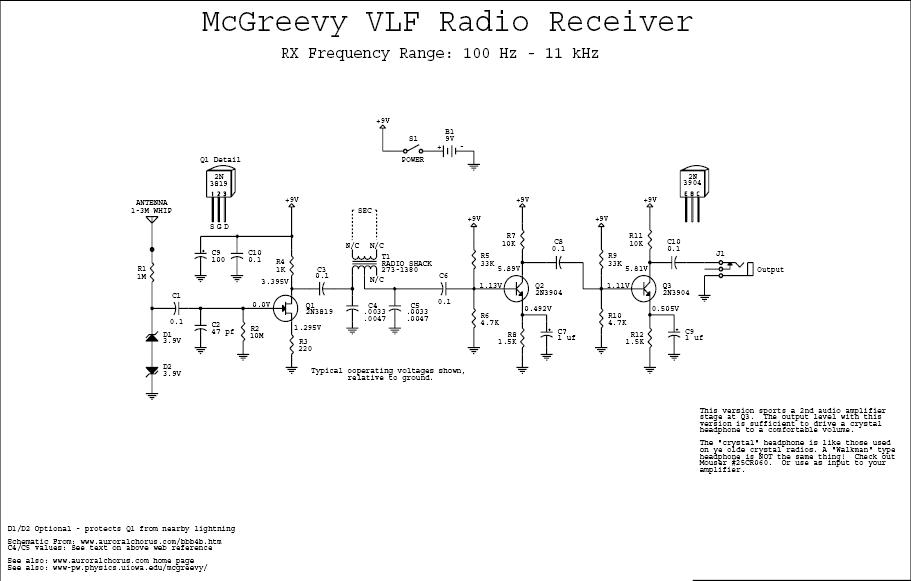

Hi to all.
I was asking if the vlf rx circuit that i m posting,could it be used for remote sensing, or to take some circuits parts to built another circuit?

Geo, the only well keeping secret is, that mineoro, rangertell etc. devices are not working. There is no other secret in their boxes.
Nelsons receiver can be used as VLF detector using strong VLF (better to say ULF) transmiters radio signals. Not realy LRL but ULF Rx detector.
Most critical part on schematic is antenna. It can not be simple wire or telescopic antenna (these are just meaningless mineoro or rangertell decoration). Antenna have to be directive (better two or even three antennas, mean two or three input stages too) and focussed to positioning small targets to 0,5m in soil. That the antenna at its resonance frequency corresponding to the transmitter frequency is understood. Preferably directive shielded, but no fully RFI shieded like usual MD coils. If one do not want to wound tausants of windings may to use a ferrite rod. This as a starting point.
After transmiter selecting some bandpass filter can be added to schematic.

hola nelson: ese circuito es para detectar proximidad de tormentas, detecta los distantes rayos, mas o menos hasta 200 kilometros, ( si la atmosfera esta cargada ') su sonidos son como cracks craks, tambien cualquier radio sensible detecta esos cracks, pero hacer un lrl con eso necesitaria otras etapas de filtros y amplificacion, nada facil, ya que se cuelan hasta los roces con la ropa de nylon, o interferencias incluso cracks de fugas' y siguen algunos insidiosos cracks, de todos modos el unico que podria sacar de alli un lrl , con su experiencia, seria alonso o esteban, yo tengo en receso un proyecto igual, y ya estoy pensando en filtros de cores' o toroides, pero lo detuve para hacer otras cosas, y luego todavia faltaria la discriminacion, asi que hechale calculo, un saludo mi amigo

Check out this interesting site. Lots of ulf/vlf receivers circuits and loops for natural and man made signals.
http://www.vlf.it/
Old 12-17-2009, 09:25 PM
Very well Altra, right things,
read this:
http://www.vlf.it/matteobruna/ULF_Induction-Coil.htm
this is right way to VLF Rx detector.
Old 12-17-2009, 10:29 PM
Altra Altra is offline
Join Date: Jul 2007
Posts: 6
I read that article, good stuff. He said it did not work very well. But I think that is because its very directional. Thats good for us!

Here is somemore on the circuit!
http://www.auroralchorus.com/bbb4rx3.htm
I think , directional antennas ( coils) more convenient than telescopic aerials for treasure hunting .

Hello Nelson:
yes, may be for this receiver, you need a big ferrite rod, you find in:
www.coilws.com
www.stormwise.com
the low frequency penetrate very good in ground, and if you go to one site with big treasure in ground, you receive a null.

I think ferrite antennas is the best choice for vlf receivers.
Like some at http://stormwise.com But in smaller Size!
VERY LOW FREQUENCY ANTENNAS 700 Hz - 10 KHz
Data Sheet:
http://www.stormwise.com/MUF21-700H-10K-BC.pdf

If you go to Steve McGreevy's website he has some info about his receivers. He says you need a stylist (whip) type antenna and that other antennas won't work for this type of receiver. Now maybe this is just for listening to whistlers, etc. I don't know. But you ought to read what he says before you go out and buy the wrong antenna. Follow the link here, scroll down to "Final Note"
