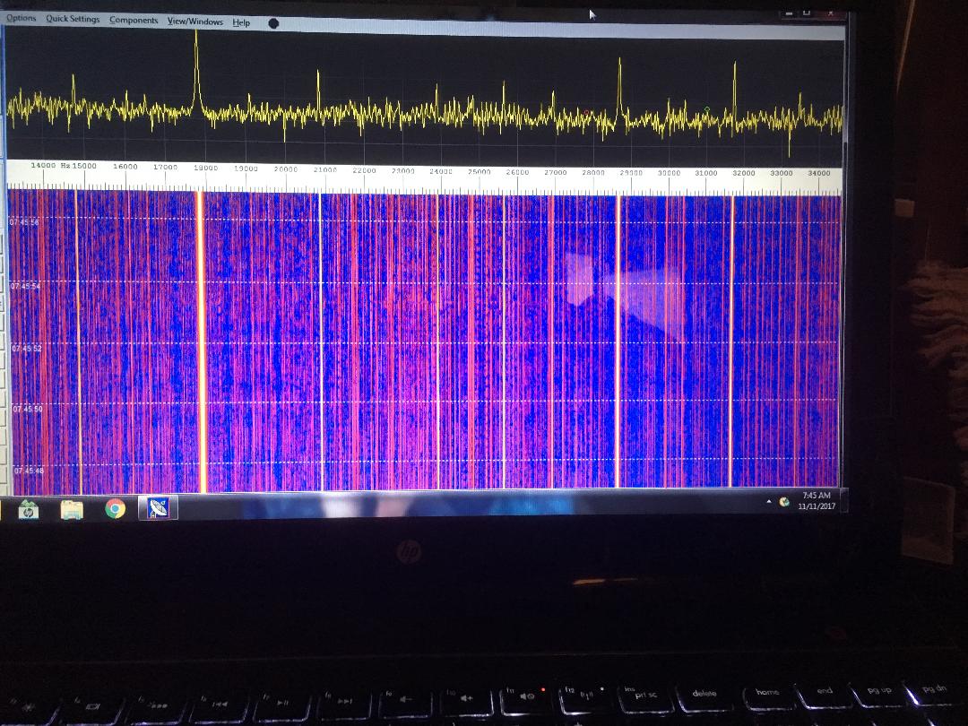

My spectrum analyzer is a bit unconventional. I use a SuperSID monitor I got from Stanford.edu (think I paid $60 or something) and built a coil maybe about 30 inches square with magnet wire. Can't recall how many turns (400 feet of wire), but whatever they say in the instruction manual on-line. Then I run this through the Spectrum Lab software. Since my laptop does not have an internal sound card I got the SD-AUD20101 which has 24 bit 96 kHz. You can get by with less if you don't want the higher frequencies, but it's cheap enough. Anyway I just place the LRL near the coil in line with the windings. There are other DIY SID monitors on line. I was going to build the Gyrator III. Got the board but...
Old 11-11-2017, 03:19 PM
Posts: 2,124
attempt to post photo
This is the Mini-Eliminator with TRN on
set to 18kHz
You can also see some VLF stations at 21 something 24.8 and 25.2
Old 11-11-2017, 03:22 PM
Posts: 2,124
This is a VLF metal detector at 18kHz
Note harmonics
Old 11-11-2017, 03:24 PM
Posts: 2,124
First photo ME-II on SID software
Second photo VLF metal detector
both at 18kHz

I don't know if those are harmonics because they are not in multiples of the main frequency. It's hard to see exactly what is on the SID software because it adjusts the scale automatically.
There are other VLF stations there, too. Check the frequencies. Hawaii, Iceland.

Hi Carl, sure, you might be right, I mean partially right.
When I first set up the Spectrum Lab i was getting harmonics then when I switched on the TRN the harmonics got closer together. It was like a capacitor was being charged.Could have just been some time delay with the software, I don't know. My brain ain't working too good these days. i can't get it to do that now. I could have damaged something. So don't worry about me, I've pretty much given up on becoming a rich and famous LRL salesman.

Mike, I think that is hard to see something by connecting a receiver to a spectrum software and walking around from a signal generator.
Remember that the coils, are directional receivers and by moving a coil receiver in the vicinity of a same band TX, you will read an electromagnetic chaos this time.
If you want to use a LRL with a VLF TX/RX, then you need some tricks, like cancelation of the primary TX field.

Yeah, this set-up is just to check the output of the Mini-Eliminator II.
