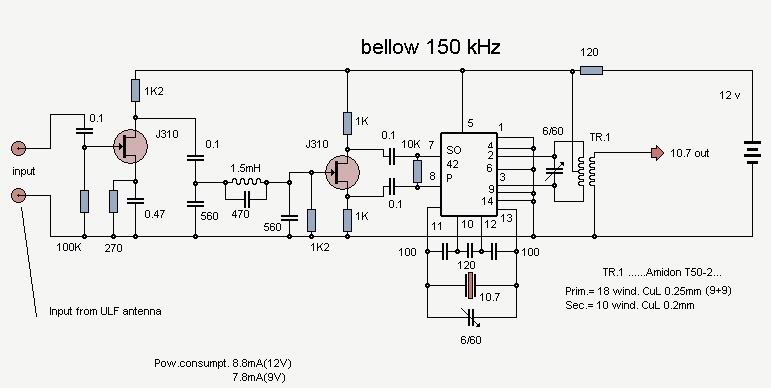

I was busy last week....but since promised some ideas
here is a primer on main part of vlf/ulf receiver....
For the end i sugest a simple 10.7 IF from some radio
.....for example u can use some based on CA3089 or even
better on MC3357 or similar...3361,3371,3362,3359.....
even a simple transistor design would do a job.Further
analyze can be obtained,taking a part of signal from
later stage....(i am preparing some schematic on that).
For antena I would sugest a loopstick or even better
special design i am preparing and gonna post it soon.
You may experiment by winding 600-100 wind. of Cul 0.5mmm
on ferrite core, 30-45cm long and 3-6cm thick.
This is just an idea,I am very busy these days and off
.net so here is a little something just for a start.
regards....

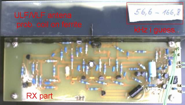

I opened UG 12 yesterday and found very simple device in the box, except the PIC 16F873
part...considering that .hex inside is probably protected during programming.Since I am
sort of familliar with pic's lately,i also know it is impossible to re-read it once is protected.
It was possible to gain some success with the early 16C84 ic's, but that bug was fixed
on 16F84 series. On 16F873 series is impossible to do that. The whole design is splited on 3
parts.Simple receiver, some kind of converter/buffer and Pic part with eeprom and rs232
(or simillar)communication part.The pic pcb is very "pro.look-like" and it seems that they used
already prepared "general use"pcb and just programmed pic.The other two pcb's look very
"hand made" and simple and can be easy copied.As i presumed, you need a ulf receiver and a good
software to analyze received data.Also there is a data logger included in the design with
16 000 samples capacity.
When u switch it on the pc, software transfer data from logger in to pc and later u can analyze
it on many ways."Nice and clean". Despite the price of 8000 e, still i would like to copy it and
make another.Is there any chance that somebody have .hex for UG12 pic !!??? I do have software
for pc also, which comes with device.It looks very simple and easy which provokes me very much!
O.K. ...now ...is there any chance to get that .hex for pic or not? If somebody know how...come
here and join the company!
This is it. I am gonna continue with my own ulf project and when ready i do intend to post all
here....for everybody to see.
I am very interested about your opinions people....come and talk..

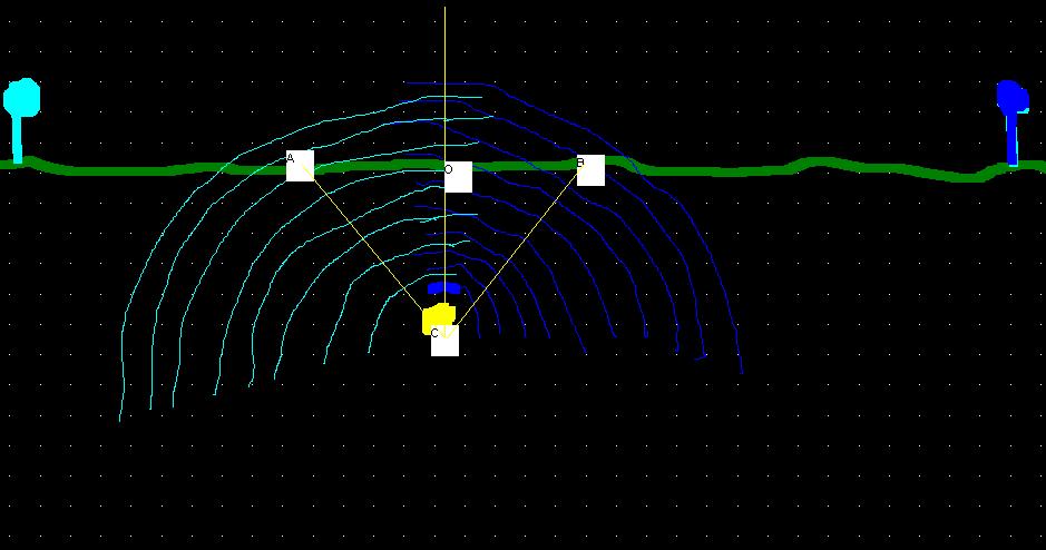

Hi İvconic,
ok emfad is not a magnometer.
just ulf or vlf
I can not understand that
our vlf detectors like garret and whites, they have transmitters which is really close to target than base stations of radios or else.and they can not penetrate deep.but this emfad does.HOW can it do this.
frequency used in detectors is lower than emfad recievers.
and how can differ cavity and metal?
in pics I tried to show dept determination of ulf .this is my idea but logical.
there are lots of stations on earth.each have different frequencies this is why we ne broad band reciever .
each color in pic represents different station and frequency.
according to drawings
angle CAO = angle CBO ,say X degree to this angle
our selonoid winding(antenna) also has recieveing angle which is equal to 2X degree
so
we measure the lenght between A and B ,= L
then divide 2 = L/2,
sin(X) / cos(X)= TAN (X) =dept of target / (L/2)

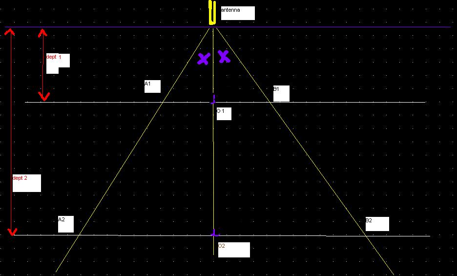

Old 10-01-2006, 10:58 AM
okantex okantex is offline
Posts: 154
while you look at this pic,think that the path you are walking on is sank to the level of target and think A,B,O at that level.it will be easy to understand my thoughts
thanks for yur interest
and can not we increase dept by using transmitters

For the first step i'll choose to make a receiver which is about to receive
those freqs. That receiver should have a very narrow angle of rx.It just
need to include a highly directional "antena". It will be only a first step.
It is a start.
Waiting for reply...
I can not understand you want to narrow angle.
if we want to increase dept,it is related to power of base stations.and can not help in this manner.
but willl effect dept measurement badly.
because our user wil be a man and wont have constant walking speed.if he walks for long we can say approximately something.but in short distances it will be problem and this could occur when you decrese angle.
because chip will count time between start and end of signal .than uses this to have approximate L . than calculate dept.
so we can not decrease angle much.
since decreaseing angle does not have adventage on dept penetration.In my opinion no need to do this
thanks
I talked much ,I hope you will not angry me
Old 10-01-2006, 11:32 AM
Posts: 154
decreaseing angle has adventage over pinpointing
but if we use a speaker and meter we can pin point .determination of dept is the difficulties one for this project.
but the only way of having good dept measurement is keeping away from decreaseing angle much.
regards....
