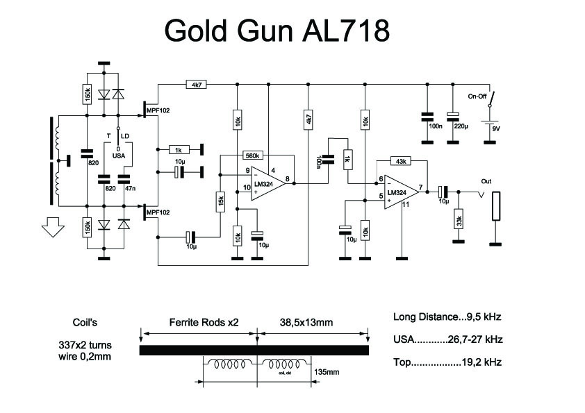

Thank you for your answer,
I have see again this schematic
It is similar with the al718, but there are some
Different value capacitors .
What model is this?

Model is AL718.
Capacitor in thank circuit depends on VLF signal transmitter frequency in your region.
In schematic given capacitor can be of little use if there are not radio signal inside tank circuit resonate frequency.
But even there are not VLF radio signal, you can build weak, simple and cheap transmitter tuned at AL718 frequency and put it in field of your search ten meters away.
You need to tune your AL718 ferrite antenna at the best directivity by changing ferrite rods mutual distance and coils position. You need transmitter for such tuning placed of about 50 meters away (good one is battery powered signal generator with two wires - one inserted in earth and other as antenna up in air).

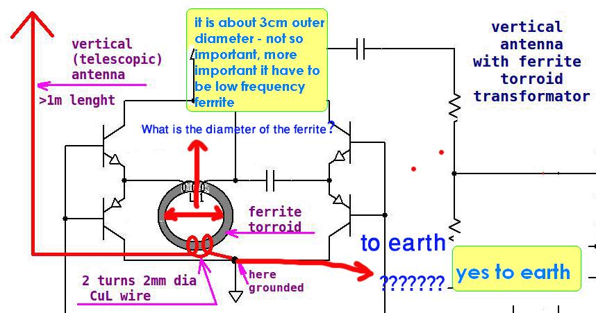

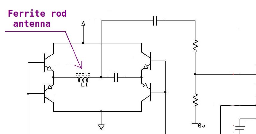

this is a transmitter vlf with coil anttena .How to change the antenna coil to the telescopic antenna.???
You can use the transmitter for the Said wm6 ???

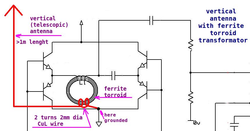

In two ways (not to mention that L1 alone works as antenna too: to bigger diameter - to better signal):
1. You can build L1 as ferrite rod antenna with same inductance (regarding to desired TX frequency) for better antenna directivity.
2. You can build vertical (or telescopic) antenna by help of LF ferrite toroid transform with his primary windings tuned to desired TX frequency.
Old 12-20-2011, 11:05 PM
In two ways:
1. You can build L1 as ferrite rod antenna with same inductance (regarding to desired TX frequency).

If one end of a telescopic antenna is no longer with the same frequency is sent to Earth to be what?
How is this possible?And better performance for gold gun ?

I'm sorry dear wm6
How can one end of the telescopic antenna to Earth????
Is it possible?
How to Plan???(A telescopic antenna and a signal transmitter to the ground together)
This will help the gold gun receiver to detect metals???

Maybe now I understand.
Yes it is possible that one end of antenna to be grounded to Earth. Look at last drawing and find point with comment "here grounded". You can instal wire from this point to ground. With this connection antenna is grounded to Earth.
GG can theorethically detect something (what and on which distance still need to be answered). You cannot expect to detect coins at distance, but maybe bigger deposits of metal. It depend on directivity of your GG receiving antenna.

What is the way to tuning the transmitter with a gold gun?
Both have to work on the same frequency.
You get this by tuning LC tank circuit in Tx and RX antenna stages.
Try first with say 10 turns on RX ferrite rod, measure inductance, calculate whole inductance of say 500 to 1000 turns, calculate resonance frequency with C of 1 to 10nF, repeat the same with TX.
Read post #4 too again.
Old 12-22-2011, 02:28 PM
Please explain how the vlf transmitter with gold gun????
What do you recommend to set the frequency?
Please see the picture and identify specific areas?
Mr. wm6 please explain about how the vlf waves in the Earth and in space.The telescopic antenna transmits its own waves in the Earth without ground wire?
with tespect
Antenna can emmit better if grounded:
