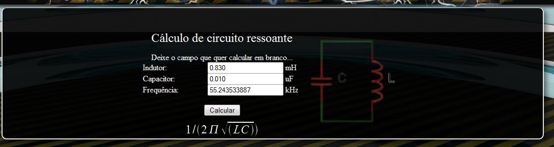

Hi you can use this for calculate depending on your frequency choice
50Khz - 60 khz or 80 khz or 100 khz
and the capacitor in parallel to coil
around 630 and 830uh following capacitor
http://www.energylabs.com.br/el/calculadora/lccalc
http://chemelec.com/Calculators/C-L-R-F_Calc.htm
http://chemelec.com/Calculators/Inte...tance-Calc.htm

Hi all
If someone want to change the frequency preselected by me which is between 50 and 80 khz
you can use a variable capacitor in parallel with your coil and following your calculation of the inductance of the coil
see here
https://www.google.tn/search?q=capac...w=1388&bih=735
use this website to calculate the values ​​of C and L variable uH
or this
http://chemelec.com/Calculators/Calculators.htm

Hi dear not again
It's sample my friend need to calculate your frequency with the parallel capacitor
and make diameter 50 mm with core 0.35 mm
I cant told you what number of turns because that need calcul with LC
maybe L=> 820 milliHenry and 90> turns R => 6 Ohm but not sure check by your self my friend

Hi likng look here can Help you
http://users.telenet.be/h-consult/in...n_inductor.htm
For L= 830uH
Capacitor 2n2 >>>> Freq = 115 KHz
Capacitor 10n >>>> Freq = 55 KHZ
You can use Capactor variable 10nF
for frequency between 55 to 155 KHz
and make your calcul and your test
