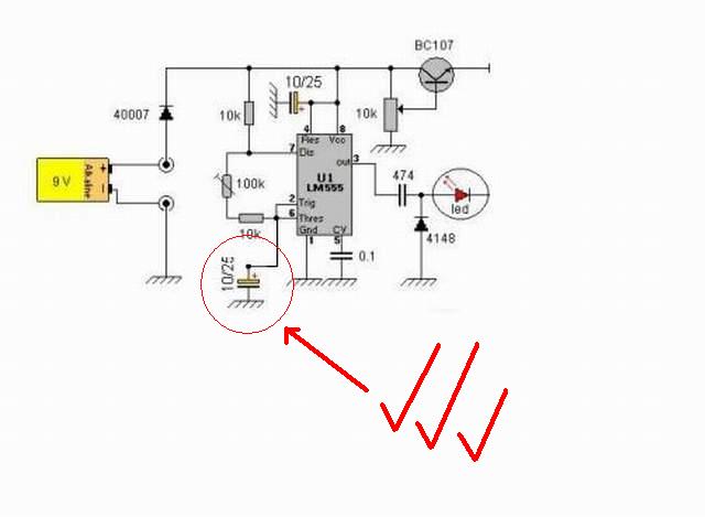

"First, Ivconic should build the detectror circuit and tune it and test it to insure that
it works for collecting ions. Then send only the circuit boards to me along with trim pots
connected (this is to make inexpensive shipping cost)."
Huh! A whole cost to build that ions detector would be $20-$30, for you J PLayer.Since I am
living in Europe, in Serbia, what do you mean, how much it is gonna take for me to send to
you assmebled pcb!? Incuding shipment and anoyance through post and other stuff. Serbia is not
even a member of european community, so there is no way to send enything by usual channels
like it is a case in the rest of Europe.Costs would overcome $100 and more!Forget about that.
If you want to check that device than you have to build it yourself.
I made it for some time. It is working and it is detecting ions for real.

One more thing, during the test i switched off a 555 part of the device, and guess what?
The detection was attenuated appreciably, and some other weak noises occured.
So the 555(polarisation of dish) is acting very important role in the project.

FrancoItaly
"I noticed in Ivconic's circuit that there is not capacitor between pin 2/6 and ground
of LM555' stage, this capacitor would determine the output frefrequency.."
JESUS !!!! It is true ! I am sorry i missed that! Here is a reclamation....
regards!

The best solution in my opinion for the LM555 stage it's a DC to DC conversion by an oscillator of 1 khz or more in according with resonance frequency of the trasformer and then we may use LM555 oscillator or 2 X BC107 as astable
multivibrator with a voltage up to 50 volt. I think that the voltage on Dish is it' subordinate to its physical dimentions.
My next steep will be to build a mix of ZAHORI and Ivconics' circuit without LM555 stage and with a only stage in high impedance imput... I think that ZAHORI it was the founder of the long range family... perhaps also Minero...

To FrancoItaly
Franco You can not possibly expect LM358 to act like 555 !?
Power supply is already 9V ! As I told before, no need for regulator at
all.That is the catch!Concerning all mentioned just remember a transf.
rate 1/1.5 (aprox....it should be a bit more).And freq.can vary from
1-5Hz (i think).Voltage is aprox. 15 v. We don't have to be neat in %.
About AC component, yes there is a "microscopic" tremble.About those
rect.diodes....they can be debated so.About other transformers...I
really don't know, I never tried any other type.56K modems, here are
very cheap 5-6 euros, mostly "made in China" stuff.But transformer
has some code I mentioned before, and I met some types with Motorola
logo on.Resistance is 45 ohm and 75 ohm, although my DVM maybe is not
so precise.
I agree J Player.
One more thing again.I would rather pay attention to improve stage which
comes after second TLC272. Until that point everything looks nice to me.
It will take more stages,buffers...i don't know. It just has to be
experimented with.

Hi Ivconics,
For our purpose I think that the LM358, double single supply operational,it can easy replace the LM555: it has a frequency range of 1 Mhz and a current output of 50 ma...
I use it very often and I have a circuit board with this IC for ewperimental uses. Do you have measured a voltage of 15 Volts between Dish and ground?

Hi,people!
I am very busy these days, I simply can not follow you in this very
interesting thread. But ideas are more than inspirative. I would
tell you again, let's just leave for a moment a 555 stage. It is
working just fine and no need for any mods.Let's just focus on further
signal analyze after the second TL272.
Second, I was thinking already to make some experiments with VLF
bellow 150 kHz.Not original at all, I know. Just look at the GISCO
EMFAD UG12, which is basic primer. I was thinking to use already
existent VLF signals from remote TX's as it is the case in UG12.
But further talking about that will dilute this subject of ion detector.
Somebody ask about dish dimensions.It is stated on schematic.
I also made experiment with one plate taken from old 8" ancient hard
disk as a "dish". It will need some experiments too. Many mails come
to me with a questions about real ion detection on the field. It seems
that some people had just skim visits on this thread.People,read this
thread and every post letter by letter! Many questions are already
answered here.It is not productive to talk about same questions here
again and again.(This is not addressed to the registered members here).
I was tested ion detector and it is detecting my "home made" ions for
real! Airborne ions...maybe. Burried gold and relics....NOT! Why?
I guess cose burried stuff do not produce ions at all, or at least, not at
wanted quantity!Than why are we talking about that device here on
forum like this one!? Because huge number of people are still beleive
in that theory that burried things can be detected by detection of ions.
I can not disallow that theory as i can not prove it either.But it will
take more experiments and mutual contributions to establish some firmly
attitude on that matter.Until that, i can agree or disagree with both
sides in many points. Delayed tribute to Dell for his contribution on
this thread, although i would be very joyous if we switch from very
academic to some more practical talk here.I mean more schematics,less
talks.Schematics do talk it self.Mods,schematics....schematics..mods.
J PLayer mentioned some ways how to further analyze signal from detected
ions.That is the point! J Player can you post some schematic on that here?
P.S.
FrancoItaly
"Hi Ivconics,For our purpose I think that the LM358, double single supply
and a current output of 50 ma...I use it very often and I have a circuit board
with this IC for experimental uses. Do you have measured a voltage of 15 Volts
between Dish and ground?"
Yes.Between 13.5 to 15.xx volts. About LM358...maybe so! But why wasting time
on that? 555 is just fine.You are straying of the main problem.What we need
from that stage, 555 is already providing.Again no need for higher voltage.
Higher voltage on the dish is a mismatch.Higher freq. on the dish is a huge
mismatch.1 to 5, even 10 Hz is just fine. Starting point here is that we supposed
to deal with ions, not with any kind of waves.Unlike in the ANKER post where
we had a case of nonsence explanations and jumbled various scientific principles.
Again leave that stage unchanged and focus on the further inspection of received
signal.Regards to you friend.

Ivconic built this machine and it is working fine for him. There are 2 parts to the detector: The charging circuit, and the sensing circuit. You can test the charging circuit with a digital volt meter. Connect between the dish and the battery ground. you should have at least 12 volts. if not there is a problem in the charging circuit that needs to be corrected.
The sensing circuit is seperate from the charging circuit. There should be no connection between the two. Test for continuity between the ground of charging circuit and the ground of the sensor circuit. if it is less than 1 meg ohm then I would look for where the leak is. Also test between the antenna and dish. This should also be more than 1 meg ohm. If you find these two circuits are connected, then there is a chance of damage to the TL op amps.
If these 2 tests test ok, then the remaining sensing circuit is a simple differential amplifier and power amp stages to run a speaker and meter. You can test each stage at a time to locate the problem. be careful with the TLC271 and TLC272. These are FET devices and can be easily damaged if you touch the leads when you have a static charge on your hands. Use a grounding strap on your wrist.

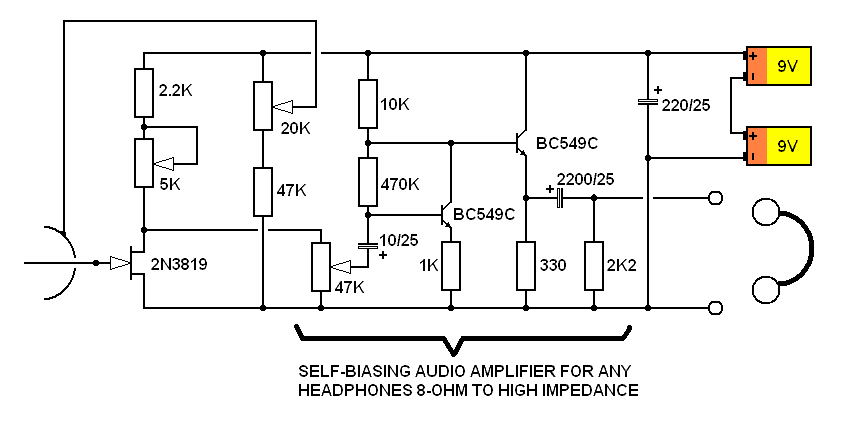

Here is a simpler design for an ion detector based on a very easy ion detector at this link: http://www.zen22142.zen.co.uk/Circui.../staticdet.htm
The author says his detector works for finding ions in the air around ion sources. It is a sensitive detector because of the high impedance FET, but maybe not as sensitive as Ivconic's design with 2-stage FET amplifier.
My modified version of the simple circuit is below, for use with headphones. I have not tested this circuit, so some of the front end resistors at the FET may need to be adjusted. The audio amp portion is a working model that will make sound for any headphones from 8 ohms to high impedance. The dish charge is adjusted between 12 and 18 volts directly from the batteries and a potentiometer, thus eliminating the seperate charging circuit. This method of charging may introduce more noise into the signal, but maybe not.
