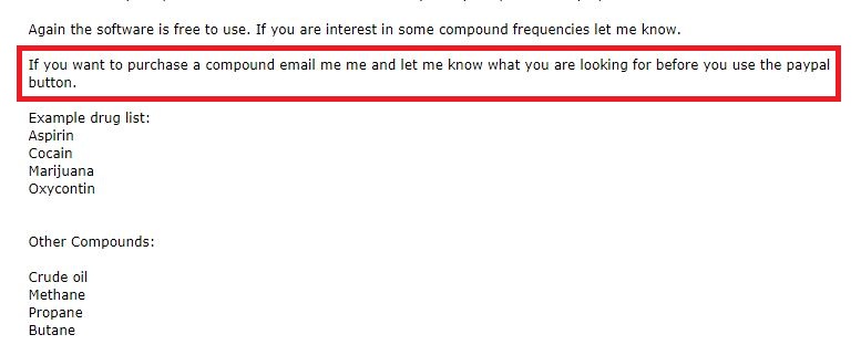

I've received many emails on NMR for dowsing. So I wrote a little program to display the frequencies. If you want to test these have at it. I have had interesting results. Best to use sine wave with these frequencies.
http://lrlman.com/efnmr.htm
Have fun.

Seriously? You are going to sell frequencies for dowsing?
Good grief

Jim why don't you offer to give out frequencies by email. Or write a program for those that want compound frequencies. The program I offer is free. That's more than you offered to anyone.
Let me know how you do. You should get a good response.
Your responses are sways offending and belittling. I've yet to see a encouraging post from you on any forum or subject.
To answer you question. Yes. Do you need a compound frequency? Maybe to locate your meds? Send me your med name and I'll give you the frequency free just so you can get back on them ASAP!
Lol
