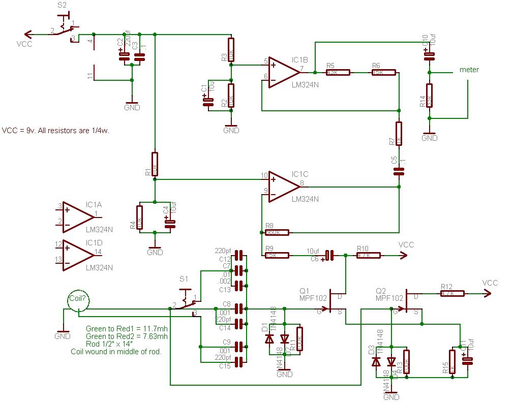

sorry,only have this model

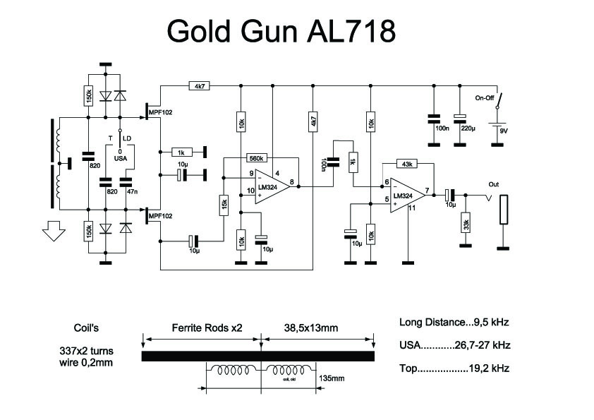

Thank you for your answer,
I have see again this schematic
It is similar with the al718, but there are some
Different value capacitors .
What model is this?

Model is AL718.
Capacitor in thank circuit depends on VLF signal transmitter frequency in your region.
In schematic given capacitor can be of little use if there are not radio signal inside tank circuit resonate frequency.
But even there are not VLF radio signal, you can build weak, simple and cheap transmitter tuned at AL718 frequency and put it in field of your search ten meters away.
You need to tune your AL718 ferrite antenna at the best directivity by changing ferrite rods mutual distance and coils position. You need transmitter for such tuning placed of about 50 meters away (good one is battery powered signal generator with two wires - one inserted in earth and other as antenna up in air).

Model is AL718.
Attachment 17641
Attachment 17643
Hi Morgan
what is the first schematic and third one ? there are two different lrl? or we have to make both of them to make a gold gun ?

GG AL707 schematic is well known and tested. You need to read threads about GG Al707 from start.
Capabilities to detect something with GG AL707 are more theoretical than practical (main problem is proper antenna tuning). In all cases you can detect with this devices a bigger ore underground deposits only. But device is cheap, easy to build, work better than all mineoro and other scam devices, so it is worth to try.

For J.PLayer, my friedn i was tryiong to understand this divice function and i compared to pdk, wich is also a VLF receiber.
About GG, i think that is not necesari to have the correct ferrite to catch the correct frequencies, cause you can use other ferrites to or may be the same arrange has pdk RX coil. The point is to set the correct frequency by just doing a correct LC circuit tune to the frequencies you want to recibe.
May be by just building a small vlf transmiter, like coil stimulator made bu pdk, will do the job to.
Yes, Nelson, the main point is correct frequency. Mean frequency tuned to transmitter that can be received in your local.
There is a little use, even if you have original GG, if there is no TX frequency on which GG is tuned in your local.
You can replace non-existent (military) local VLF signal transmitter by your own portable one. I have already posted some adequate TX schematic here.
