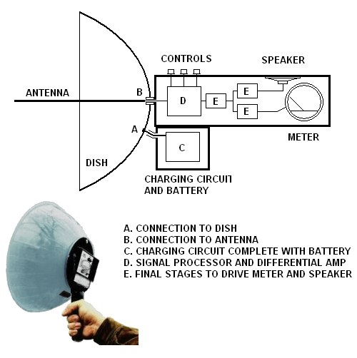

Very well,you can develop better antenna for this LRL,but also need something very ligth,satelite dish ok but one of the smaller.
As i told,this is one LRL experimental and open to many modifications and improvments for better performance.

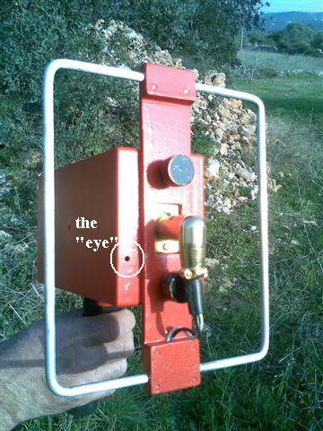

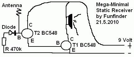

Morgan you're right with the antenna, 'cause the pistol-MD shouldn't be too heavy.
Accupack, Case, electronic, Antenna - maybe all together 1-2kg max.
I've been lucky with my FET find 'cause I found this info:
"2N5485 is a viable alternative to the seeminly weak MPF 102"
And I've constructed already circuit01 - see below.
It is very simple and uses two NF "low gain" transistors (the most common ever) but it has already noise output via speaker, even without any antenna!
The principle is an AM diode receiver with audio amp but without any tuning capacitor or ferrite-transformer-coils and you can built it at 1x1cm size even without pcb. Very sensitive already because it justs needs a 470k resistor as "electron-feed". No sparks audible so far.
Perhaps this will be later just the audio-stage. For amplifying such week electrostatic signals i have to check what noise level all those parts have and maybe an op-amp LM358 or LM324 makes a better job. And I'm already curious how good the field effect transistor will receives "whatever"..
Anyway - my first receiver circuit after a very long time and this is just the beginning!

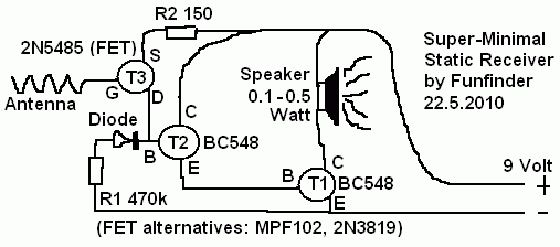

  #29
Old 05-21-2010, 07:01 PM
Funfinder's Avatar
Join Date: Feb 2010
Posts: 482
Talking It works!
Silver Ring lying on cartboard detected from 15-20cm! over some sort of transformercoil I attached to the gate. Hum vanishes if ring is near.
So far no shielding and built on a plastic surface - no problem!
FET 2N5485 drain to antenna in (see schematic) and source to +9V via 150 Ohm resistor. Everything else like before.
Antenna- and fine-tuning-experiments will follow soon.
Thx for ya help Morgan and as you see already it also won't take very long to perfectionate the whole thing.

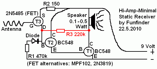

  #34
Old 05-22-2010, 08:03 PM
Funfinder's Avatar
Join Date: Feb 2010
Posts: 482
Smile
http://www.multiupload.com/FJ82JS1ID5
With the new added resistor (red dots only connected) you can see in the video loud and clearly how the ring gets detected which swings from a thread til 10cm with this improvised coil - with both cables at the FETs gate. The circuit now is much more sensitive and louder. Perhaps the basis of T2 needed some additional current, but I don't know why this has to be te one from the speaker.

  #36
Old 05-23-2010, 12:22 AM
Default LRL improvments
Directional works only with grounded reflector. I made some fancy tests with my mini-tesla-coil plasma ball which got detected from 1m.
And I tested an op-amp LM358 connected at the output of the FET - louder but important analog signals were missing so I still use the transistors.
Perhaps antenna- and out in the wild-tests tomorrow or in the next few days.
Hello Funfinder
In this last video i´m convinced your LRL is detecting the ring.
This is one way to simplificate the project,and probaly we dont need to use the BFO circuit. Thanks for this improvments.
Can you tell what kind of diode you have in your device ?
Thanks

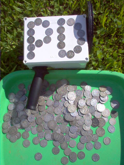

Default PD
WHAT ABOUT THIS WHITE ONE PD?IS BETTER THAN THE BLACK ONE?
This PD in the photo (with silver coins) is the clone,it works very good.
But the original works better.
  #49
Old 11-25-2010, 12:00 AM
Both are in same working condition - both cannot detect nothing in soil: not from remote, nor from vicinity.
Except if targets are buried by yourself - than you detect not by PD, but by SD (Self Deception).
  #50
Old 11-25-2010, 09:38 AM
To be slightly pedantic - self deception applies to dowsing gadgets and certain electronic LRLs, but the PD does have a real T/R metal detector built-in (a Heathkit GD348 ) and therefore is actually capable of detecting metal buried in the ground. The debate surrounds the claimed medium-range detecting ability, not the short-range. By the way, I say "medium-range" because the PD does not claim to be a long-range detector. The term "long-range" is reserved for the idiotic claims of target detection measured in kilometers.
