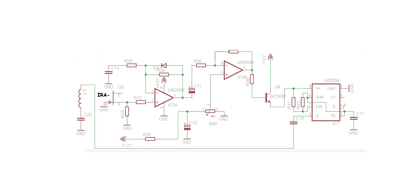

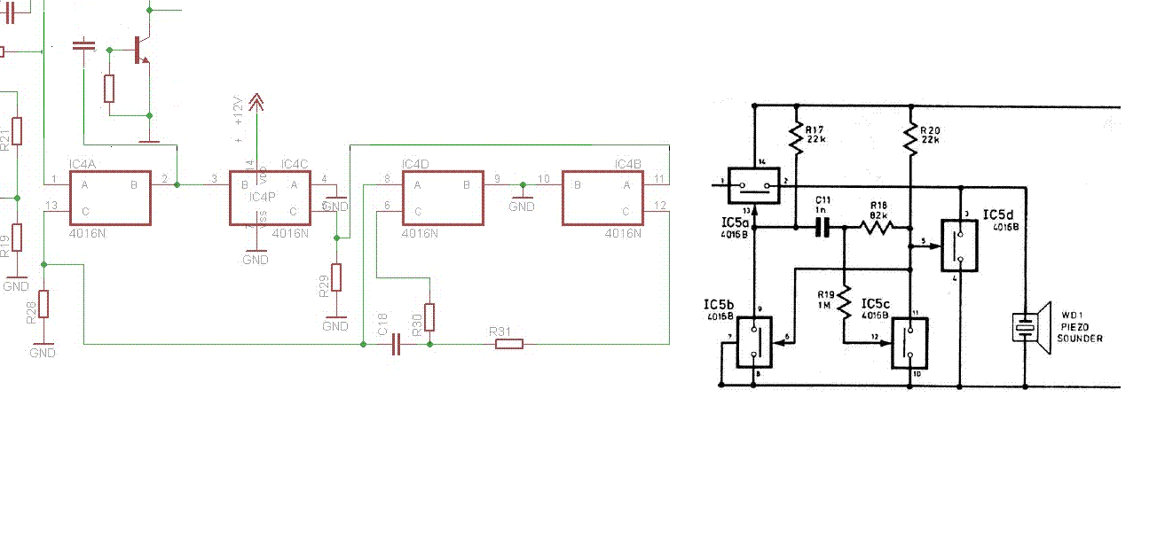

The audio stage does not work, I think there is an error ???

Your circuit and the original are not the same, I need values of your circuit, thank you Geo!
  #40
Old 01-30-2018, 04:47 AM
GOLDEN LILLY's Avatar
Posts: 147

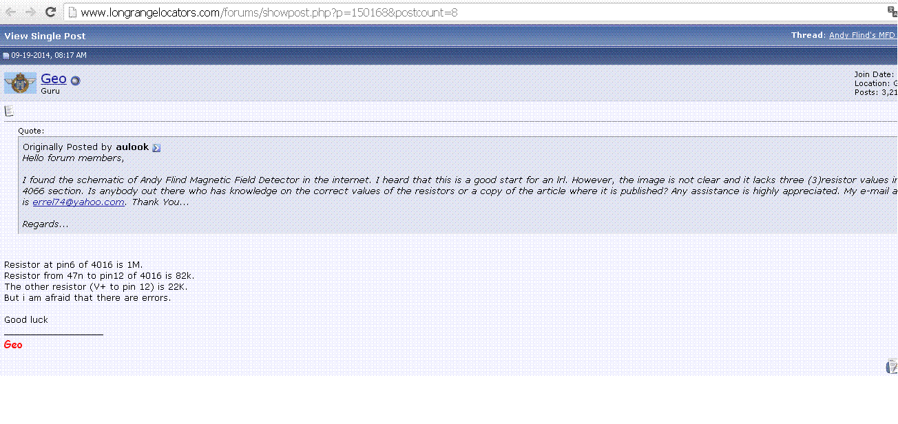

Of course it is not the same. The circuit drawn by Geo is a modification from the original circuit of Andy Flind. In the original circuit, the 4016 directly drives the buzzer but in the modification, the same 4016 drives a tone generator using 555 ic...
The circuit is exactly the same.
4016 and 4066 are quad switch ICs, so no problem if you will use the 1st switch or 2nd etc....
The schematics have diference only at pins, nothing else.

I check it's still wrong, when I approach the transmitter the LED lights up all alone, and when I get closer than the buzzer produces a weak sound .
I think it's not normal that the VU alone displays before (CA3130 + 4016 + NE555)
what do you mean by an error in this post Geo ?

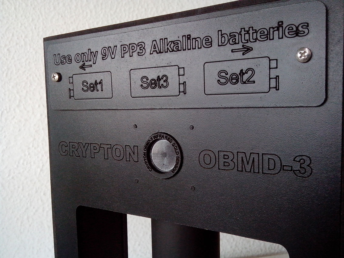

Originally Posted by dragomir View Post
GOLDEN LILL Yhow is the role of the infrared sensor when it is enclosed in the box?
Dear friends!
Position of the IR sensor on the Crypton OBMD-3 LRL device.
Sneshko

Dear friends!
Sneshko
This I think is purely aesthetic decoration

Yes, its a decoration with a purpose.

Dear friends!
Sneshko
At obmd3 there isn't IR.
But if there is or not.... same results. Nothing....
