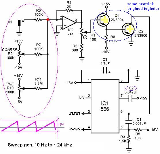

Something that can suit your needs:
http://www.analog.com/static/importe...ets/AD5930.pdf
Or even NE566
Amazingly, the NE566 can be made to sweep a continuous 1000:1 frequency span with just one fixed timing capacitor. Imagine, continuous linear tuning 20 Hz - 20 KHz or 1 KHz - 1 MHz without switching. A simple op-amp circuit provides the precise voltage control necessary. You set the range with the selection of the timing capacitor.

What circuit allows 1000:1 sweep without changing components?
-SB
Some circuit with NE566, like this:
