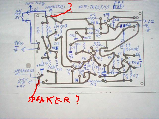

Default speaker
hello, sorry but in this project there are 2 pcb and the speaker or buzzer is connected on both sideburns? I do not understand.

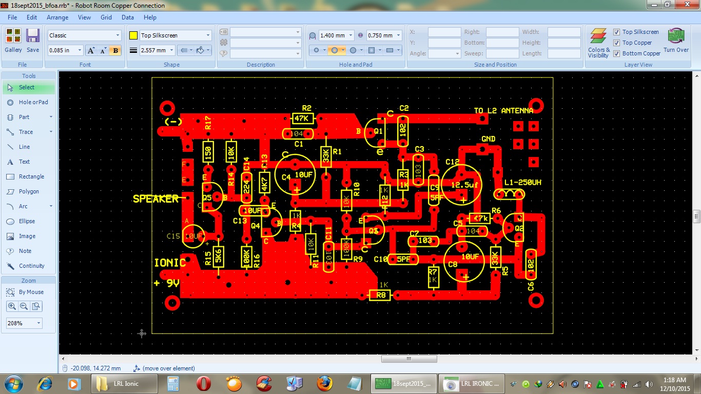

Morgan hai, hai all.
I have a little problem with the value of capacitor C12.
How Did The real value? 12.5uf? or 2.5uf, or 25uf.
Help me. The real value for c12
  #419
Old 12-10-2015, 04:28 AM
Saiman Saiman is offline
Join Date: Jan 2015
Posts: 8
Default PCB1_B.F.OSCILATOR
I made PCB1_B.RF.OSCILLATOR, circuit I uploaded here.
help me check this circuit.
And how do we know this circuit alive, or can be used

Old 01-23-2017, 02:43 PM
sorry for the delay, speaker 1 and 2 are cable connections to the BFO circuit who have the speaker.
sorry for the long delay, I have built both circuits of this LRL and they work,there is no mistakes there.

Old 01-24-2017, 11:56 PM
the correct value for the C12 is 125 uF 16v, you can check the material list in the first page of the thread.
