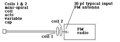

can I make some guesses and questions ?
You add a turn to the tuned circuit , right ?
That way you lower the frequency of tuned circuit from the standard 88-108 MHz FM band of receiver to something less... say 60-80MHz... ok.
But then you wire a cap from omnidirectional antenna to the volume pot... of radio and parallel it with another used for external sensitivity settings.
OK... if so... I suppose then your beep generator is something threshold detector that drives a 555 timer and give pulses to the buzzer... maybe a selfoscillating one like the sonalarme we talked about.
Ok: if there's a reduction of signal strenght at antenna at the tuned frequency , and if there's no agc control on the radio active, you'll get lower volume ... so can trigger the audio generator.
The second option is a tuned circuit after antenna and before the circuit... passband filter for the radio input...maybe tuned to a particular frequency.
All seems have a meaning till now but then...
the questions are:
1. what causes the signal strenght reduction ?
2. what's the frequency of tuned circuit and why if any particular frequency instead of others ?
3. is there some broadcast or other kind emission at that frequency that superimpose with the supposed "useful" signal ?
  #33

"You add a turn to the tuned circuit , right ?"
No, quite a turn. You can add or quite a turn, the theme is go some far of FM band.
"Ok: if there's a reduction of signal strenght at antenna at the tuned frequency , and if there's no agc control on the radio active, you'll get lower volume ... so can trigger the audio generator."
The necessary volume for to made stable and very sensitive.
"1. what causes the signal strenght reduction ?"
Maybe is associated for long time buried conductive metals. Also I'm not sure all phenomenons implicates, is complex.
A man was asked how he found a treasure in the 60's, a poor man, how he can detect the gold. And he tell with a Philips radio 6 big X 1.5 V batteries in AM. He told that over the treasure the radio was detuned! You can do this: tune a AM station and put near the ferrite a coin. What's happen?
"2. what's the frequency of tuned circuit and why if any particular frequency instead of others ?"
As you see, is for study. I remember that I connect the system antenna-small coil-variable cap. in input RF of TV and manage the tuning great, so directly can be useful for to filter undesirable frequencies.
"3. is there some broadcast or other kind emission at that frequency that superimpose with the supposed "useful" signal ?"
This is possible since this experiment: you tune near a station in FM band and positioned the small spiral coils (see drawn), move only one of them and leave the other fix. You will note that improve the reception. So detune a little the tandem. Buried metals tend to complete the tunning, so can be useful another kind of emission, but to depend of radio station is very problematic.
As Fred said, no scientific background we can found regarding long range metal detection. This FM system is for short range, maybe few meters, no more than 3 or 5 for a coin.
This job is very empiric, tons of experiments you must do... And you discover this, regarding electronic LRL: almost ALL SYSTEM you have in mind works in different grade. So the phenomenon is complex and you never are sure if electric, ionic, magnetic, but I believe is a combination.
What do you mean by small spiral coils?
Are these air-cored, wound on ferrite, flat .... or what?
  #35
Old 01-27-2008, 10:04 PM
My guess is flat air core spirals attached to plastic disks with hot melt glue.
  #36
Old 01-27-2008, 10:18 PM
Yes, is right! Just few turns.
