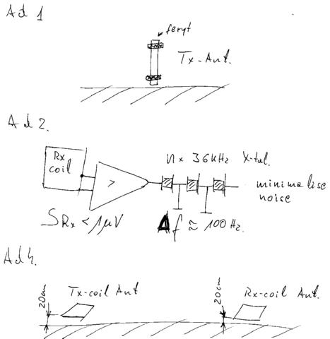

Hi, WM6, J_player.
I have some ideas for discussion:
1. Tx antenna should be the characteristics of a vertical magnetic. For example, a low power 10mW may be an antenna coil structure feryt of basketball (max Q) upright position (at the high power nature ferytu turn into a piece of wire). Maybe some other magnetic antenna Slit (but size - it could be a bad idea) . I think that 1/4 lambda antenna or coil, has a large vertical leaf levels of radiation, and we do not want to receive the signal reflected from the surface only goal.
2. Can benefit from the popular timers 36kHz quartz and pure analog generator to minimize the distortion and
harmonics. Rx side, you can think of crystal ladder filter with the same X-tals
3. I think that AM 500 kHz bandwidth makes for great Skin effect (more superficial than deep). In addition, A3 gives random modulation signal strength at measurement. Any modulation of A1, A2, A3, A3A is amplitude modulation, which forces a large measure of time - averaging.
4. How about an antenna Tx / Rx Framework 1m x 1m placed horizontally 20cm above ground level to eliminate the capacity of the soil (detuning) and reduced mutual visibility (direct reception)
5. Do you not think that we are moving close to the technology 50 years ago and described by Mikebg in this forum?
Vy 73 Chris

Old 02-24-2010, 01:35 PM
Hi Krzysztof,
thanks, I think your ideas are worth to be seen.
Can you go a little further according your ideas and post here some graphic presentation of your ideas and maybe some schematic or diagrams?
Yes, we are talking about an old radio communication technology as mikebg rediscover it too, but if it work all is ok.
It work if proper builded and used, and, as we can see, even used by modern army in different way.

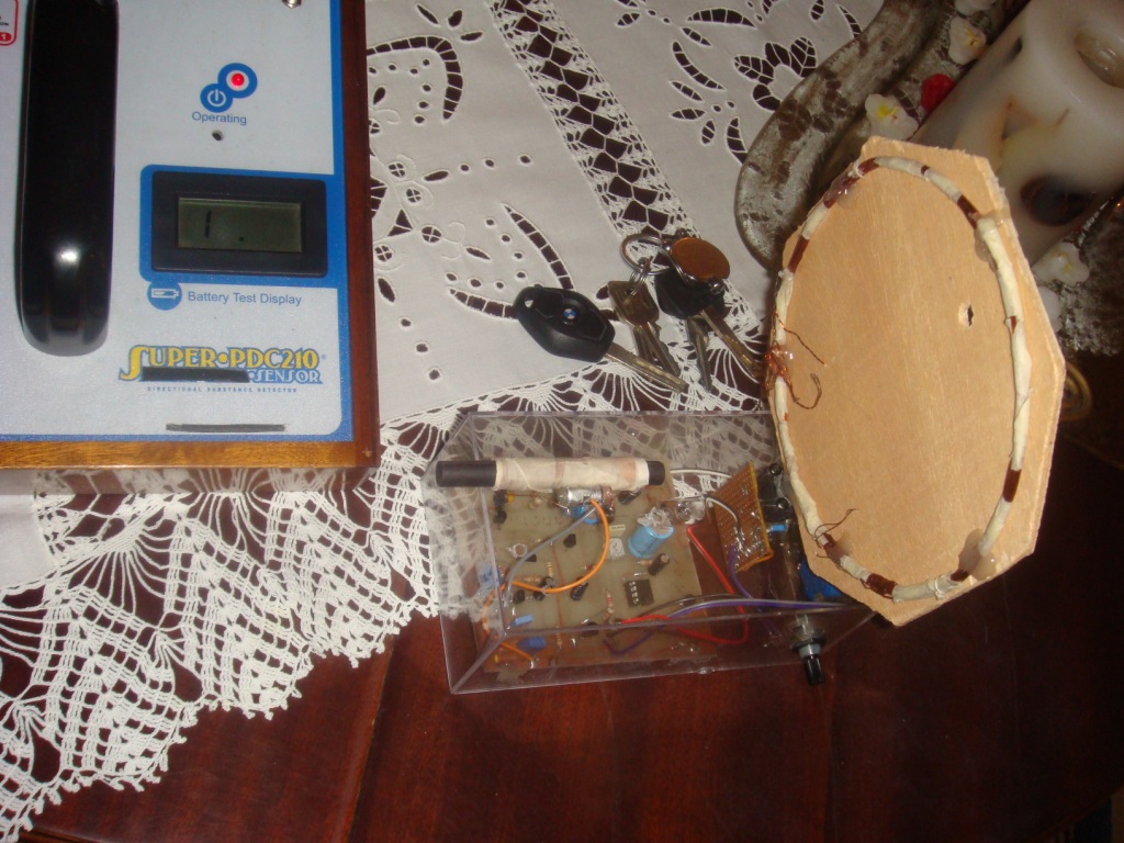

Hi Chris.
Do you mean something like the photo???

Hi all.
Modest note attached.
Unchecked idea is to use my Fluxgate magnetometer as an Rx!
Always treated the VLF and the other as EMI, now you look at it differently.
Tx antenna gives the issue a magnetic field, propagated in the ground, when it is sufficiently stronger than the earths magnetic field in conjunction with GPS and "Vumate" or "Snuffler" we are better than many well-known German company.
Who else will join the storm drain?
Vy 73 Chris
  #39
Old 02-24-2010, 02:47 PM
Krzysztof Krzysztof is offline
Join Date: Dec 2009
Location: France
Posts: 14
Hi Geo.
It looks like a mini two-box.
And I think the 2 antennas with a vertical magnetic polarity, the land
component preferably disperses component magnetic field the electromagnetic field.
Maybe someone is thinking of something better than the ferites
antenna.
Vy 73 Chris

Old 02-24-2010, 04:25 PM
Hi Geo,
you are main developer here. Are you done some test?
Yes Krzysztof, it is more clear to me now, what you suggest.
Except draving Ad.4: did you imagine RX or TX coils as a fixed scaning or mobile?

Hi of all.
I don't think so , that we're to clear forums as well bids of unfamiliar utilization present techniques not abnegating sie the old man vets. Yourselves ain't dowser , Respect those regular people whereas not swindler.
I not know gold gun , I think not , everybody they've entrance into nich as well wherefore bids of unfamiliar coinage DIY.
J_Player g_Sani.
To be sure best antenna is not they've big storing magnetically clearing switch pawn as well least radiation electricians over world ; 60 years before the communication was done ex antenna underground on figures 2 probes tributary margin ex generator engine-room undersized frequency communication (besieged troops ).
Wherefore coinage ex signal electric ex generator Tx until world is not worst.
J_Player.
Zone LF this dubious coinage. Exemplary transmitter Monte Carlo (225kHz, 200kW) premises (interference) transmitter Warsaw (227kHz, 1MW) heard on Nand France free past distances upwards of 1000km to automotive receiver wireless.
Wave worldly-minded superficial is not large what prompts breaking signal aims.
Yesterday wrong frequency quartz ex timepieces duty be 32768Hz.
I don't think so , that Tx generator to quartz 32kHz at least on often Tx clearing us ex the rubs and worries of life of stability.
WM6.
Account spool Rx clear mobil until scaning. Spool blanket 1m x 1m will correspondent , not refutes of utilization spools on the lines of MD average 30 - 40 cm , whereas depths yet never mind.
Receiver tenderheartedness 1 mikroVolt ex strait zones ex such quartz on strained serial duty be gross on hand.
Yourselves deal to spring coinage ex Rx on figures gradiometers fluxgate ( tenderheartedness some nT/m )- this so-so promisingly.
At least once EMI will be utilization.
Bids until tendering your coinage.
Best regards. Vy 73! Chris.

Hi Geo,
Hi WM6,
I made it before 2... 3 years. I tested but i had problems. It had the ability to detect a big object at 30m but it was very sensitive North horizon, at distance between me and detector and from trees.
So i let it at the side .
Maybe at lower frequency to work better .... who knows.
I don't remember sure, but i think that it worked at about 800Khz.
  #48
Old 02-27-2010, 06:51 PM
Join Date: Dec 2009
Location: France
Posts: 14
Hi Geo.
It issues me, that secret sticks (lie) in (to) in antenna with vertical magnetic polarization.
So as vertical feryt, we search something better.
And f max< 32kHz.
Vy73 Chris.

Hi WM6,
Geo, are you tried to put your ferrite antenna in RFI protective housing made from can of beer (one side open) and connected to ground of oscillator?
