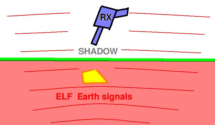

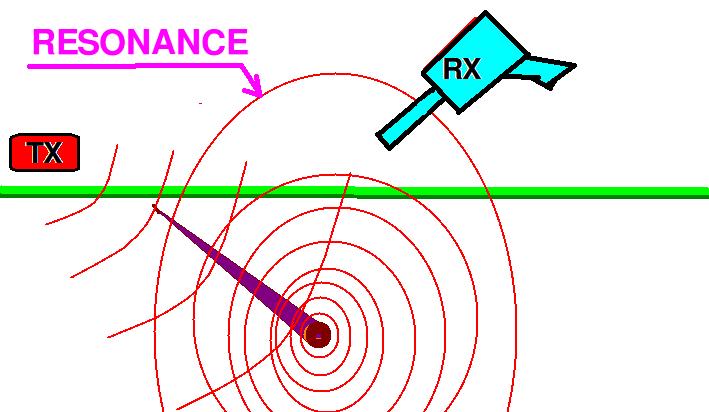

  #50
Old 04-18-2012, 01:59 PM
Originally Posted by gold24h View Post
,i would like to experiment with this but i do not understand how to use it
As already described TX RX configuration can work on 3 way:
Here presented graphically:
