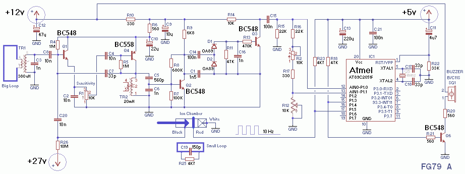

Hi. I don't know if you can find it at market but you can make one.
  #30
Old 10-12-2012, 07:36 AM
Originally Posted by putrechigi View Post
hi at everyone i hope this help to became a perfect pd
best reguards manolo
Hi Manolo, how are you??
This schematic is from FG79A and it reversed and drawned by me.

Default hi
hi geo very well now i find a job and i have a time to restart my passion oftreasure in the oter forum a people find a modification to mineoro and now he siad that work

Hi Manolo.
I can't see anything and the translator don't work
Does i must register so to allow me to see the attached schematics ???
I saw the forum,i can read spanish.
the modificated mineoro belong to our friend robalocarapanda,he said have foud 3 gold coins of carolus IIII,with the modification...
  #49
Old 10-15-2012, 09:25 PM
putrechigi's Avatar
Posts: 233
Default hi
hi morgan you know this modification?
  #50
Old 10-15-2012, 09:46 PM
Hi manolo.
As Hugo wrote he replaced the receiver with one more sensitive.
I work on it but i am afraid that i need some time....
