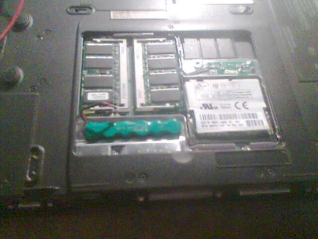

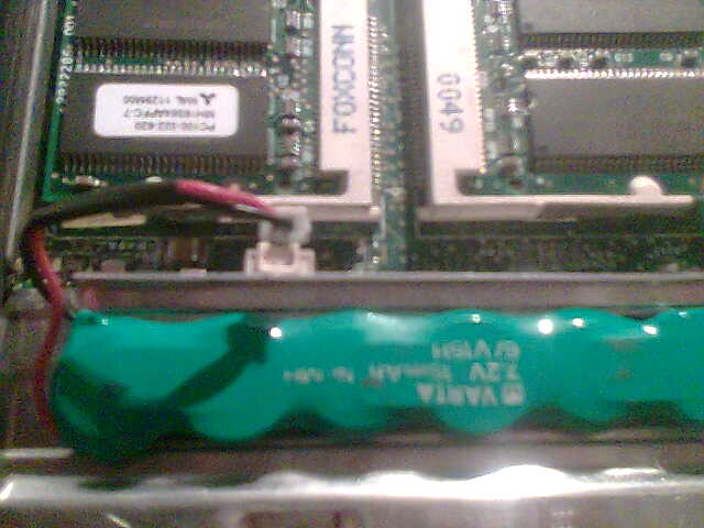

The easiest way is to open the back of the laptop and remove the CMOS battery, and leave it out for several minutes. When you put it back, the BIOS will have been reset.
If this is a more modern laptop, it may have a security chip, and removing the battery will not work. Depending on the chip, you can short together certain pins, and that will reset the BIOS.
What is the make and model of the laptop?

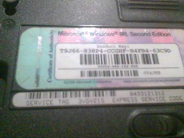

hi qiaozhi sorry iwas out door for hunting. this is image back side of laptop

About the "latitude.exe", you can save it wherever you want, but you need to run it from the command line.
It wants a 5 letter service tag number - yours looks longer than this.
