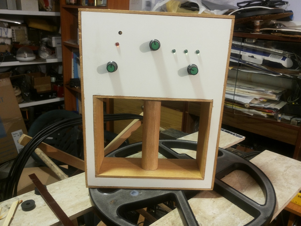

Dragomir constructed a very goog clone, i have two photos from it.
Dragomir if you would like i can post the photos here...

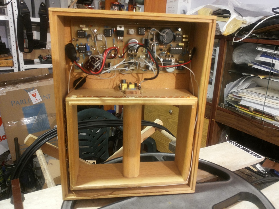

Old 01-31-2018, 11:59 AM
I post here 2 photos from a OBMD1 constucted by Dragomir.

Very nice work Dragomir

Very nice...will it really work in the field?

Old 01-31-2018, 06:38 PM
Here another photo from this beautifull lrl by Dragomir...

Posts: 80
the infrared sensor controls the power supply of the IC7. IC7 acts as an excitation generator and is inductively mixed with the signal received by the receiving coil.

Posts: 80
The IR manages a transistor that turns on and off the power supply of IC7. The IR does not participate in any process. When the device box opens, it blocks the operation of the IC7 and the excitation generator stops working. This is probably done so that the principle of operation can not be traced when the device opens.
