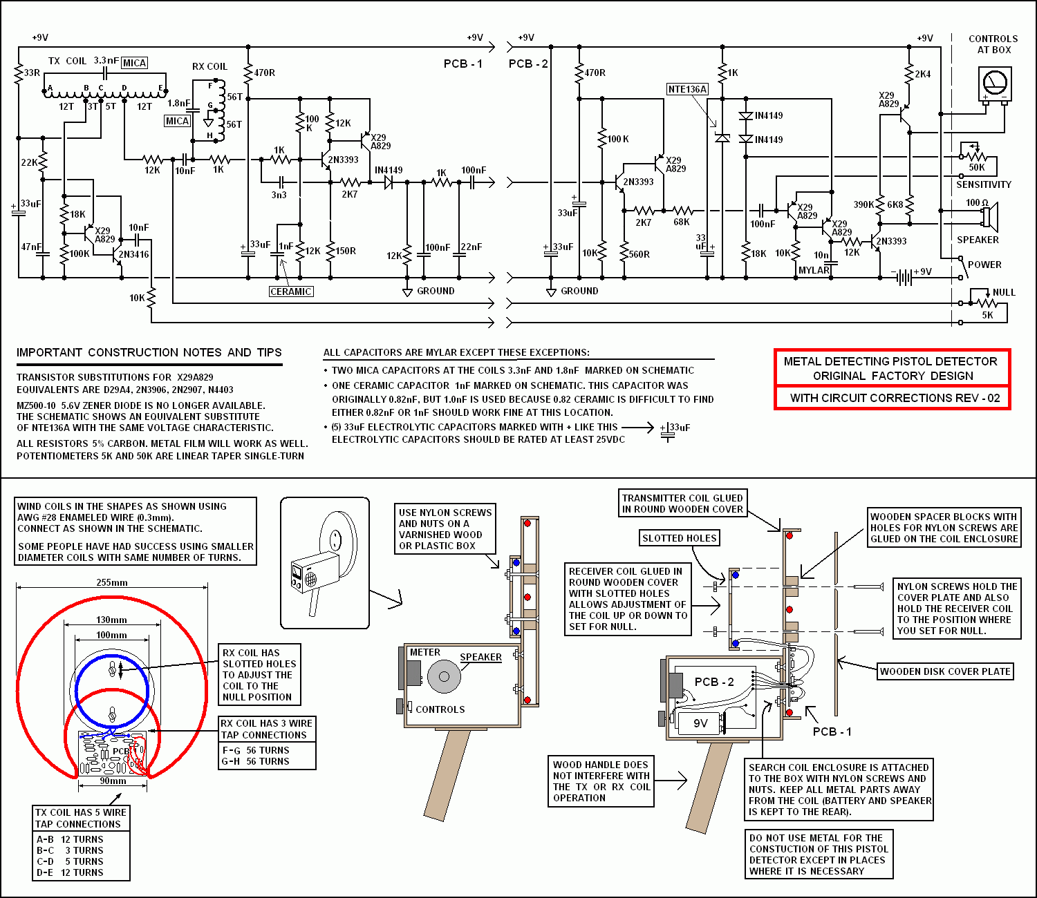

Hi kahyal.Originally posted by kahyal View Postcapacity of L1 and L2 not mentions.
best regards.
There is no L1 or L2 in this circuit.
The only coils I drew are called the TX coil and the RX coil.
See the new corrected circuit diagram below.
I have shown all the information that you need to make both of these coils.
See the schematic and the picture of the red TX coil and the blue RX coil.
You will see in the schematic there are coil connections marked A, B, C, D, E, F, G, and H.
These are the tap connections where you connect the coil to the circuit.
Between each of these coil tap connections there are numbers which say 12T, 3T, 5T, 12T, 56T and 56T.
These are the number of turns of 3mm wire you make before connecting to the tap.
This means that for the RX coil you use 0.3mm wire and you begin winding the coil at connection F.
After you complete 56 turns, you bring the wire out from the coil 10cm distance and fold the wire to make a second tap called G.
Then you continue with more winding until you finish making 56 more turns on the same coil.
When you finsih making the second 56 turns of wire, then you take the end of the wire and mark it to be tap H.
The finished coil will be tightly packed with some tape to hold it so it will not become loose.
Then you connect the taps F, G, and H to the circuit as you see in the schematic.
See the diagram below that shows how the RX coil will look if you stretch it open to see the turns.
You can make the TX coil the same way, but you have 5 different taps from A to E.
You can look on the schematic to see how many turns are shown for each tap at the TX coil.
There is no need for knowing the capacitance or inductance of these coils.
You only need to make them as they are shown on the diagram.

Hi WM6,Originally posted by WM6 View PostHi J_P ,
what are PCB's dimensions? I saw only one (90mm) given on drawing.
90mm is the size of the opening at the bottom of the omega coil, not the size of the PCB-1.
The PCBs can be any dimension you want to make them as long as they fit in the locations where you put them.
PCB-1 must be small enough to fit inside the omega area.
The original factory version has this PCB inside the coil enclosure so the leads will be short and close to the coils.
But for the PD adaptation, PCB-1 could also be put inside the box at the same location that we see for the diagram.
Then the leads will be about the same length, with no loss in performance.
Also, both PCBs may be combined as on a single board in the PD adaptation.
In this case, the VLF tuner section should be kept to the right side of the board, close to the coils and away from the audio amp.
See below for alternate 1 PCB design:

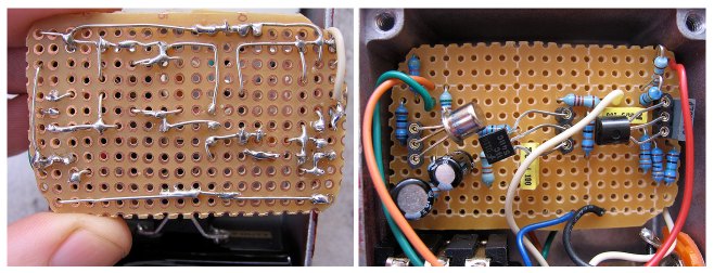

You can scroll up and see that I have explained it is good to wait before the PCB patterns are released so we will have time to see if errors in the schematic are found.
If you don't want to wait, then you can begin building the locator now by soldering this circuit diagram onto a perf-board as either a 1 board design or a 2 board design exactly as you see explained in the diagrams.
If you do not want to use perf-board, then you can make your PCBs, or copy a PCB that somebody else makes.
See below to learn what perf-board is:

The schematic you see above is not fake.
This circuit is exactly what you will find if you open and look inside the original factory produced locator.
Thousands of people bought this locator and used it to recover many metal things.
I have not read any reports which say that it works by the principle of NMR, and I do not believe NMR is the what gives it the ability to detect signals that other locators cannot detect.
I know for a fact that it works by the principle of transmitting VLF waves and has a receiver coil which monitors the signals in the air to find any anomalies.
I also know it uses IB methods which are so sensitive that it requires a separate nulling control in addition to the sensitivity control for the tuning.
I also see the designer took precautions to stabilize the circuit for temperature compensation to help keep the signal from drifting.
But I see no NMR sections anywhere in this schematic.
If you want to believe this is a fake schematic, then you may believe it is fake and you will have no reason to do anything.
But this is exactly the kind of schematic that kahyal asked for, and that many other LRL experimenters have been looking for.

He posted photos of his adaptation of this original factory locator to a pistol configuration in the forum that is no longer online.
I saw his photos of the circuit boards with components.
I could read every resistor color code, and see all the capacitors on the board.
This is how I know the circuit is not fake. It is unmodified, exactly as the factory designed it.
