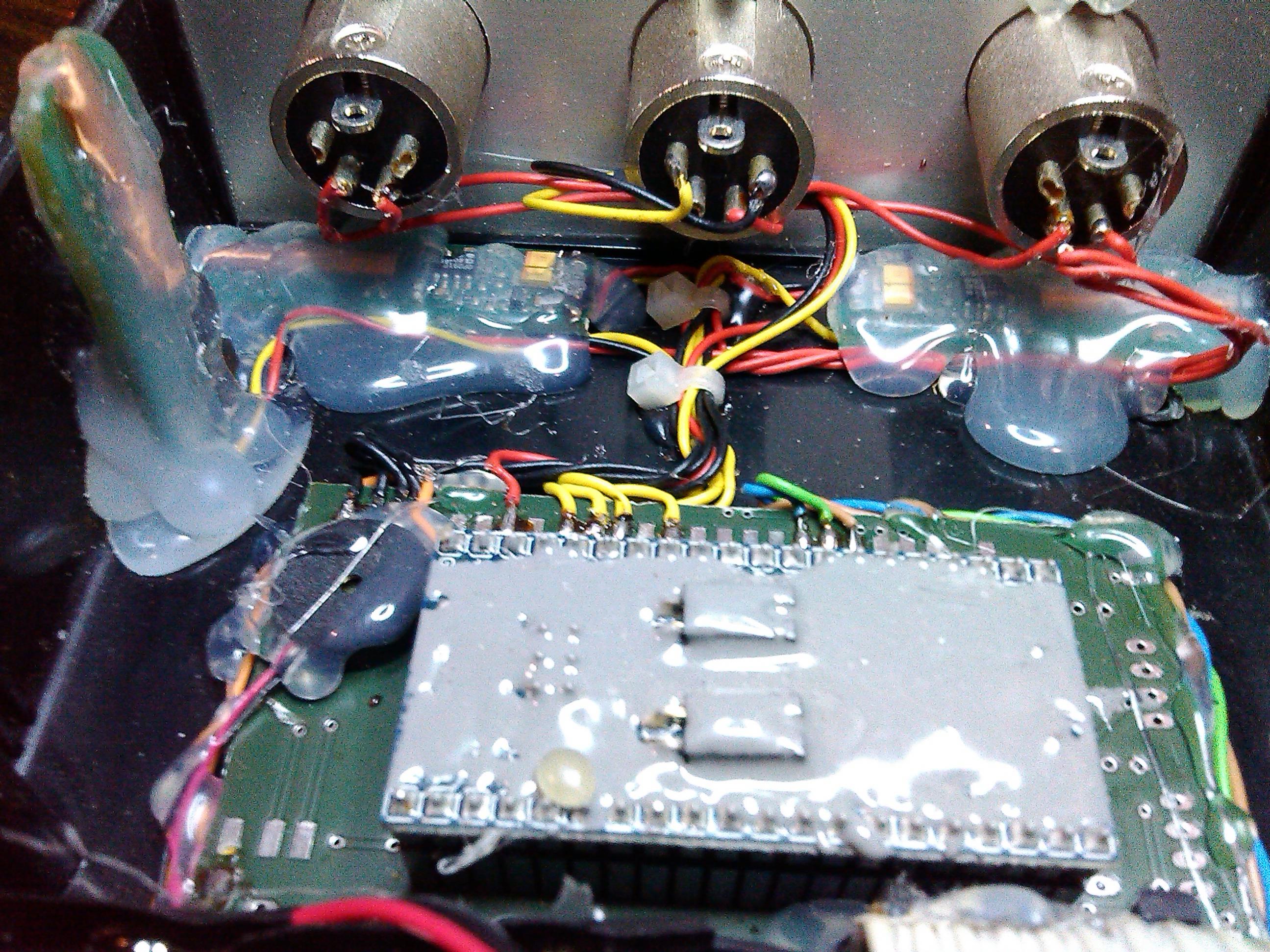

this device have flc100 magnetometer sensors, which is mounted inside the device other than the 3 antenna's up front. Two flc sensors are mounted horizontally opposit each other and logs the compass orientation of the device. The other one is mounted vertically and logs the elevation of the device. During calibration on a target like jewelries the device monitors and logs elevation and orientation to which it is pointed at and the device tells the user that its positive. Remove the target and point the device on the same elevation and orientation the device would also say its positive...

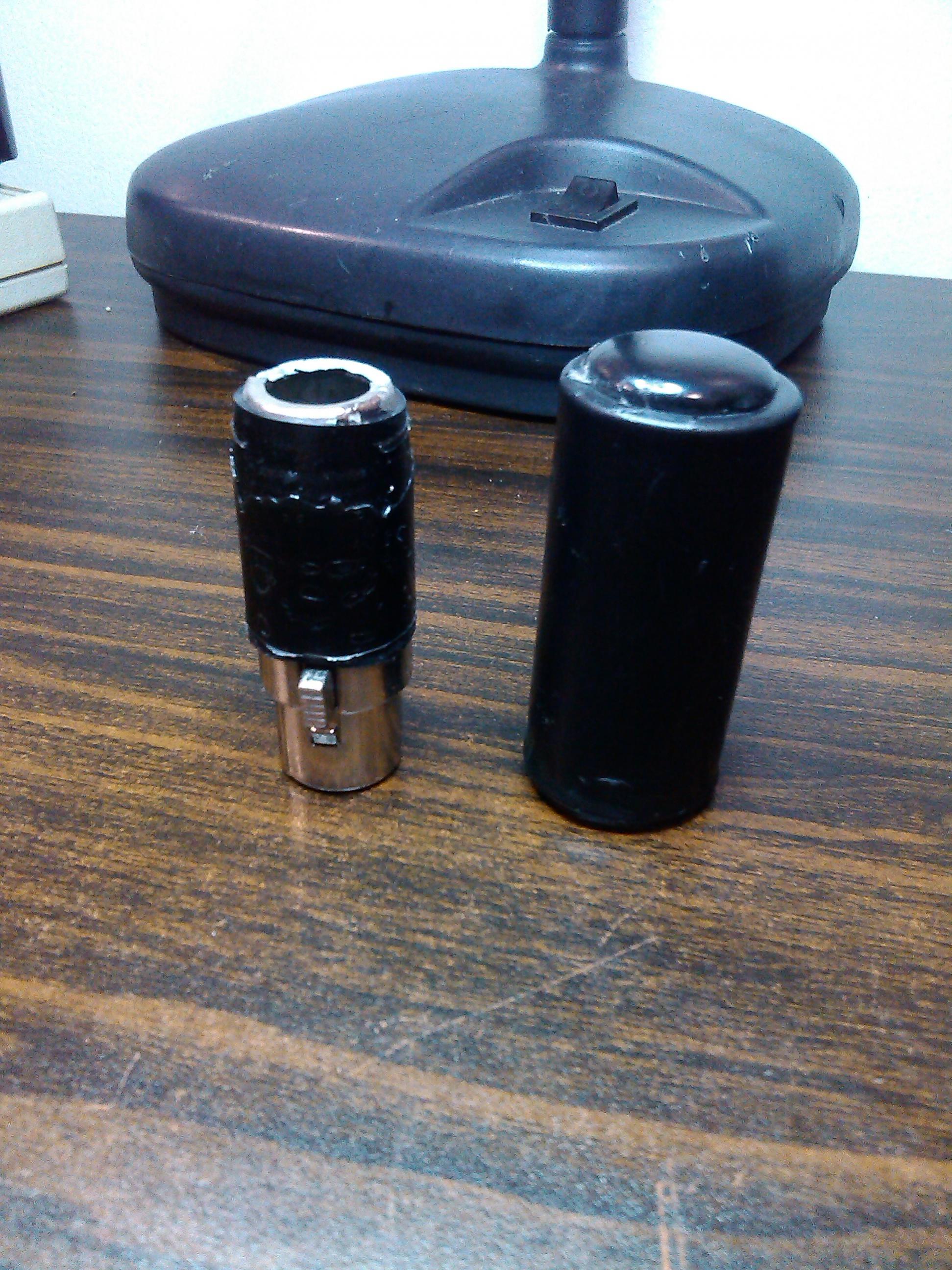

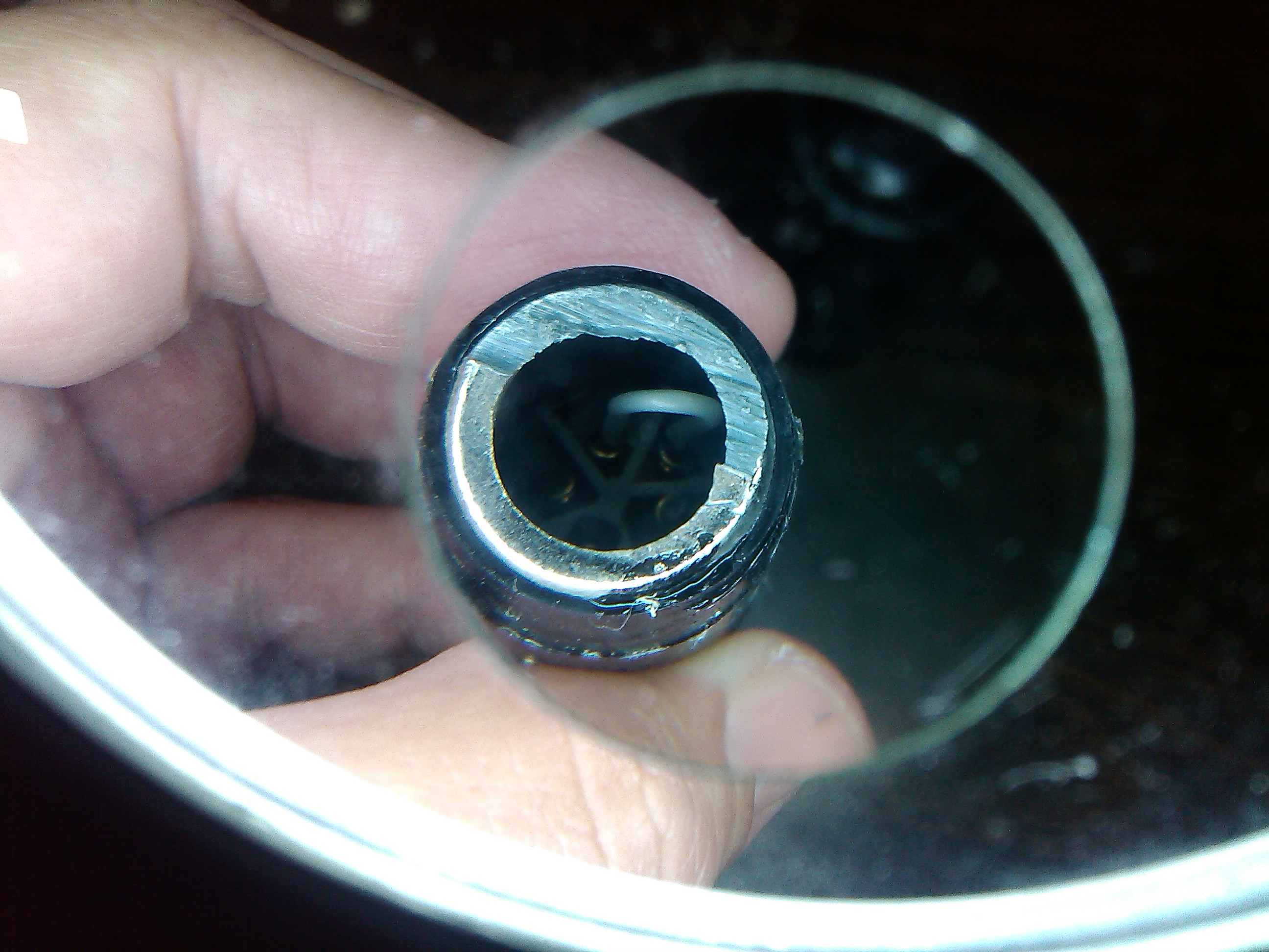

Three antenna:
two short antennas have jumper wires only which is connected to the taller or center antenna of the device which the flc 100 magnetometer sensor is mounted. The jumper wires completes the circuit to power up the flc sensor...
