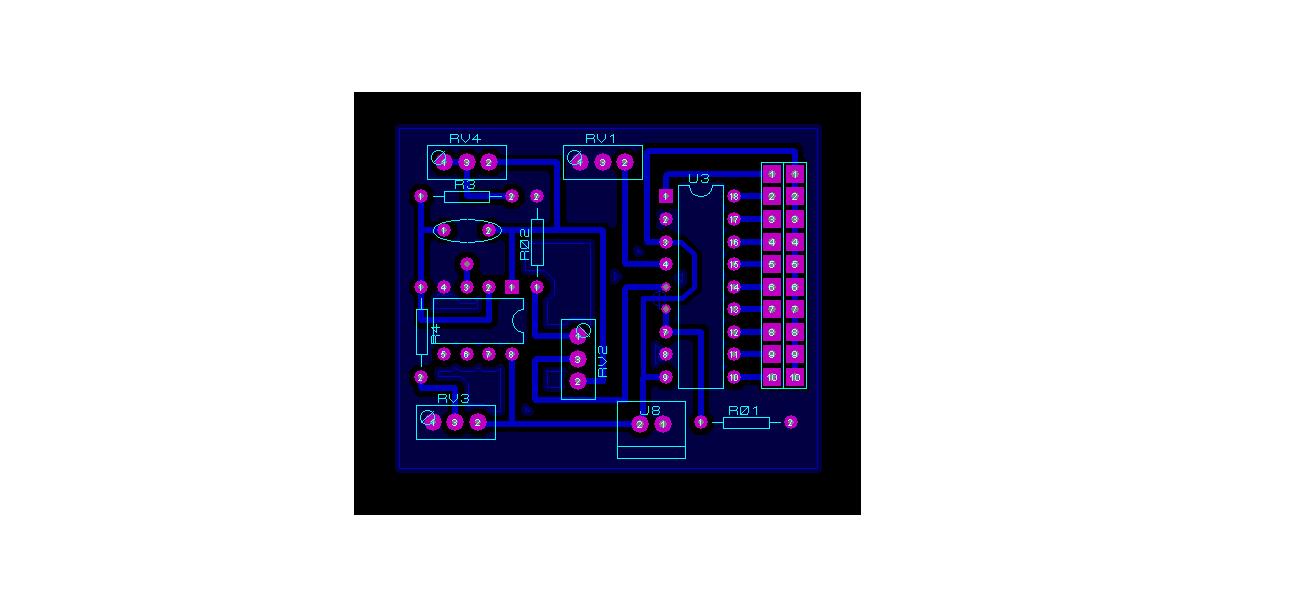

              I built CD4046+Pwer+display, but unfortunately its battery consumption is very high and don't work correctly with 2 or 4 9V. Do you have any suggestion for solving this problem?
              What type of battery or power do you propose?
              • Please see the my panel of Franco's LRL.
                There are three LEDs in CD4044 (one LED) + Pwer/display (two LEDs) (attached). Can you tell me what is function of blue LED (in CD4044 circuit )?
                In my LRL, beep only is heard by rotating Gain screw, not by Threshold. If possible, please guide me how to caliber the LRL in real environment.
                Thanks alot.
                • Hello
                  Dear All.
                  Please share list of components for CD4044.
                  Thanks.

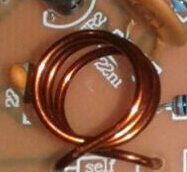

                  • Hello Franco The predecessor should be vertical or horizontal
                    • Originally posted by zixelll View Post
                      Wht's you mean for "predecessor" ?
                      • Hello
                          The coil is horizontal, but perhaps it works also vertical.
                          • Franco What is the best voltage?
                            • Is Vertical Better Suctive or Horizontal?
                                Horizontal.
