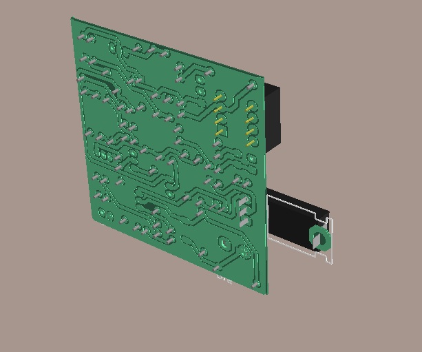

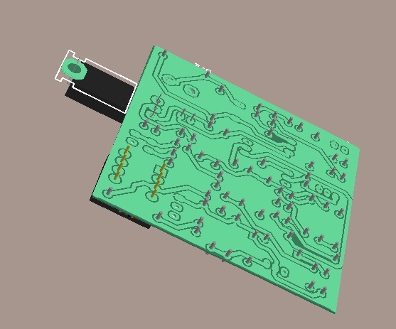

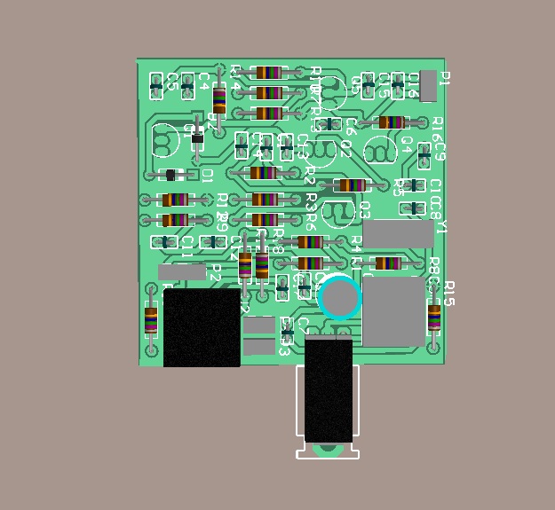

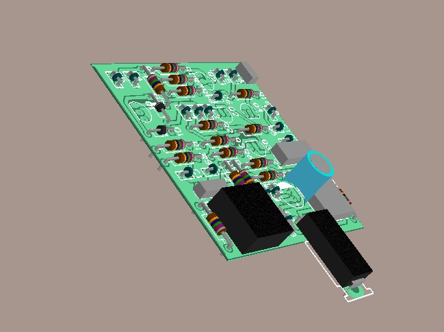

          • this is my new pcb of lrl franco.2 layers and with pulygan

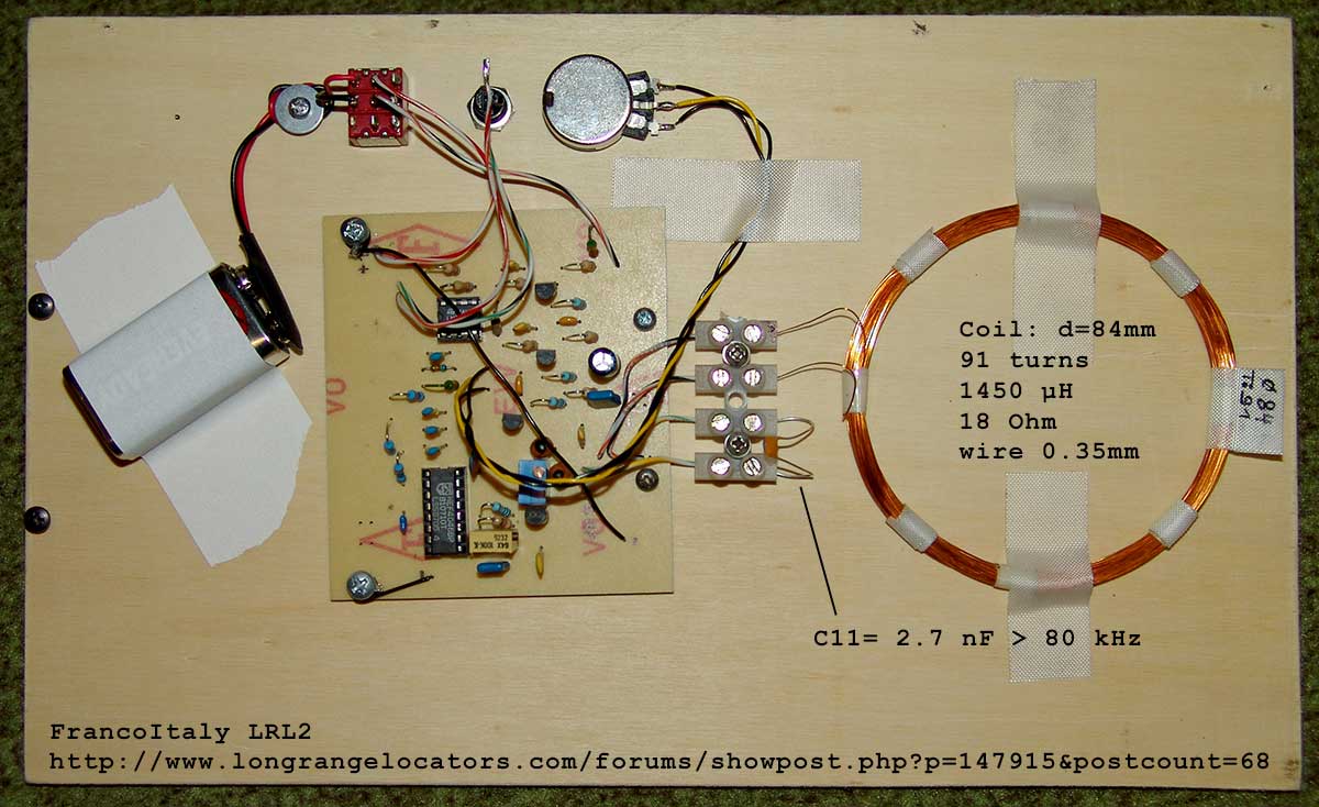

                          I've built FrancoItaly's LRL2 from post 68. Instead of the stylus antenna I've used simple coil (like the one from FreePDK). See the attached photo.
                          I don't have buried metals but did test with TV and it works from 4 meters away and through concrete walls! Potentiometer P3 is super sensible but if adjusted well then if target is recognized it starts to blink. Maybe with a precision multiturn potentiometer it will be easier to adjust.
                          PS. With stylus antenna it does not react to TV.
                          • Hi Daniel nice job and work. Use multiturn for precision is so better. And try to use ferrite coil with frequency 75khz is so better for gold
                            My congratulation
                            God bless all - Nicolas
