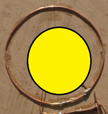

                              • Hi Mr Franco;
                                Mr Franco thank you, I have made your device with 8 MHz, but the antenna I used the model shown in the picture attached (a single round of 8 centimeter diameter) and when I touch with my hand the LED lights, is it good?
