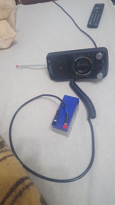

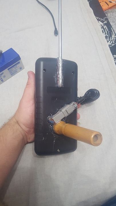

Hello Franco, the lrl is complete. Plastic box, antenna used from another device, wooden handle and the battery is external with 12.47 volts power from it. I have tested it and it reacts with the north, i dont get other signals, only that. What should i do to stabilize the compass effect? Thank you.
for mustefa: if you use a device that works at 5V you must reduce the output voltage of sensor stage (that may be also 8V or greater with a big target). Yes you may use an operational or a 5V zener diode and set the output voltage of sensor stage at about 4V.
For Napsterce: all the lrl works with a 12V stabilzed power. The only way to reduce the compass effect is to reduce the gain.

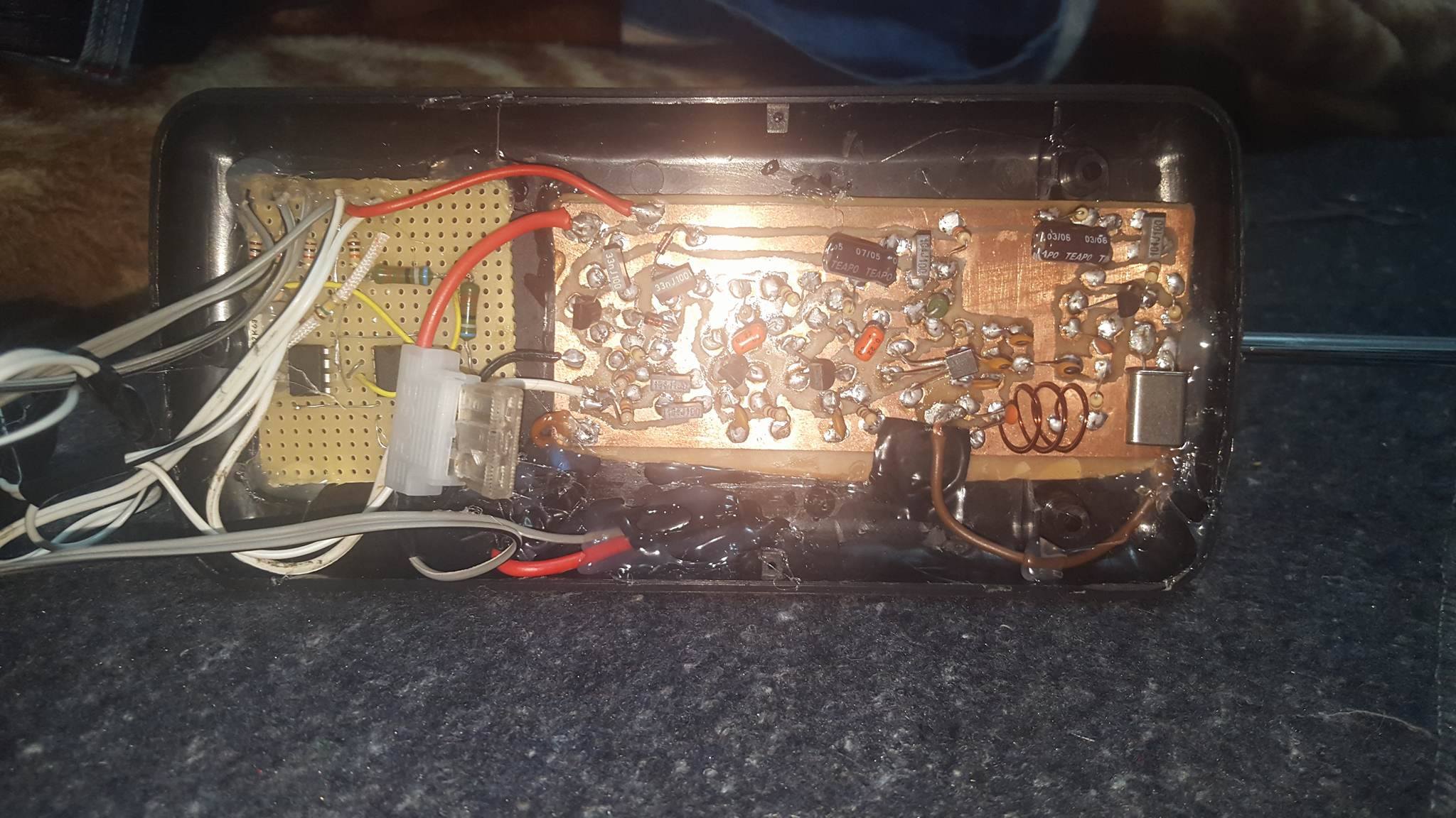

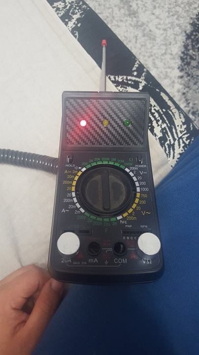

The lrl is tested at 3 places, 1 place without results, the other 2 places got all 3 led's glowing at gain set to 40-50% and sensibility set to 40-50%. The results are not 100% sure because it's not on a test field.

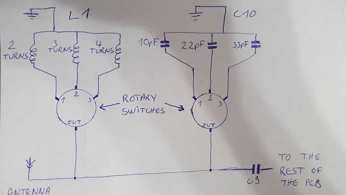

Franco i have two questions for you, how to tune the lrl to be sure it's not catching false signals and should i make a pcb with different values for L1 and C10 like in the picture? Thank you.
