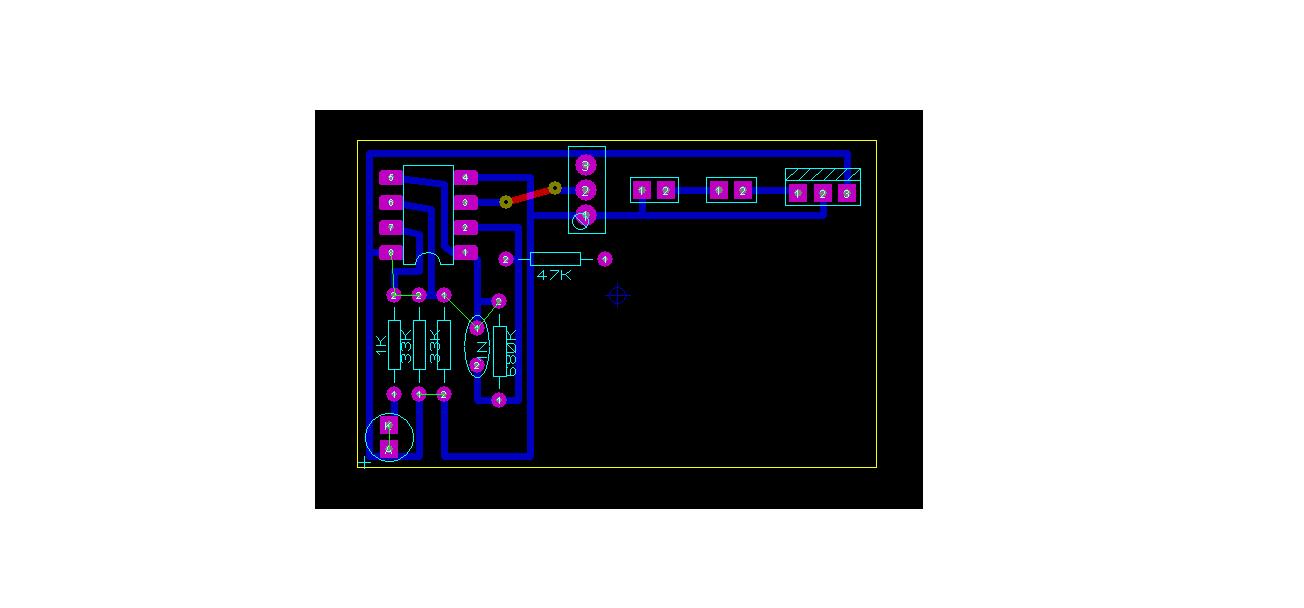

Can i do this setting with the threshold potentiométer ( i fixed the gain with a resistor ) or it must be with the gain ?

The best thing is to act on the gain, the threshold is for fine-tuning. I think that it is better to use two separate PCB for sensor stage and display stage, to avoid couplings parasites that might trigger self oscillations. If this were to happen it would not use the maximum gain for the sensor stage.
how to know that is a self oscillator , in any case the LED lights by increasing the potentiometer ?Originally posted by FrancoItaly View PostThe best thing is to act on the gain, the threshold is for fine-tuning. I think that it is better to use two separate PCB for sensor stage and display stage, to avoid couplings parasites that might trigger self oscillations. If this were to happen it would not use the maximum gain for the sensor stage.
