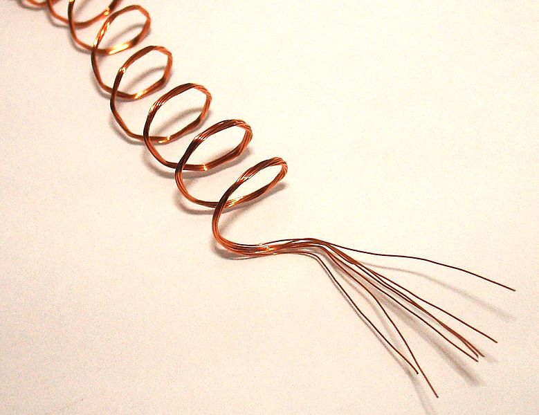

Yeah, the latest coil works good. I also found out it has a sharper null than the big loop I first built. I like the null and i was using it today as well. I check for the target then turn the coil 90 degrees and see if the null lines up the same. Sort of a double check. I also found out I get a better null when i get somewhat closer to the transmitter but not too close, like about two feet away. So the next step is to start putting everything into an enclosure, well actually I need to find an enclosure first. But anyway it is to the point where I don't want to mess with it...well, at least for today!
