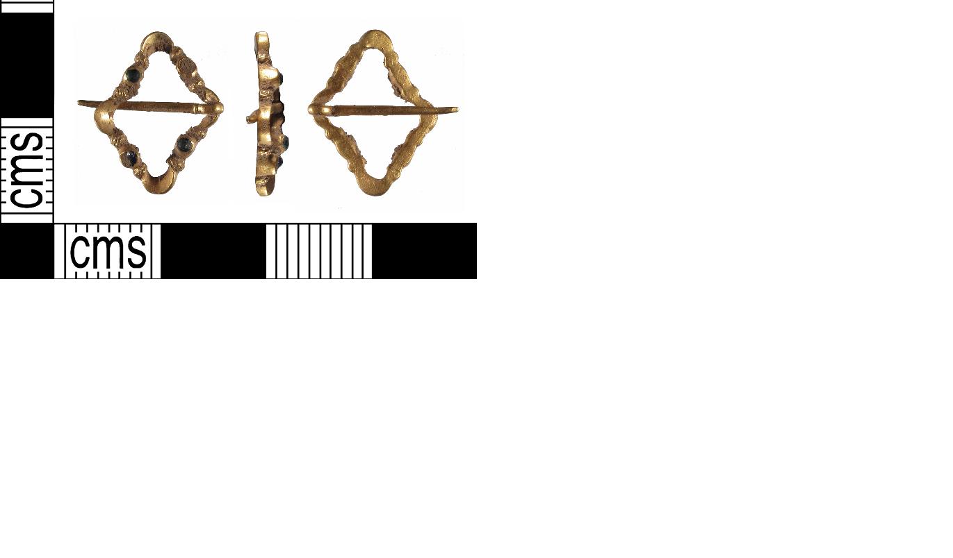

        Talking of gold I thought you all would like to see this 15th Century Brooch found by my brothering law David about 4 weeks ago at a rally we went to hear in Sussex.
        The picture was taken just after recovery and it had not been cleaned.
        It has gone to treasure trove inquest to the British Museum for valuation.
        A beautiful little brooch I think.

                  Very nice object and is good that goes for valuation,if museum not interested to buy,you can keep ;-)
                  Objects like this brooch(loop shape) create the best eletromagnetic field,the PHENOMENON,very easy located by PD or PDK.
