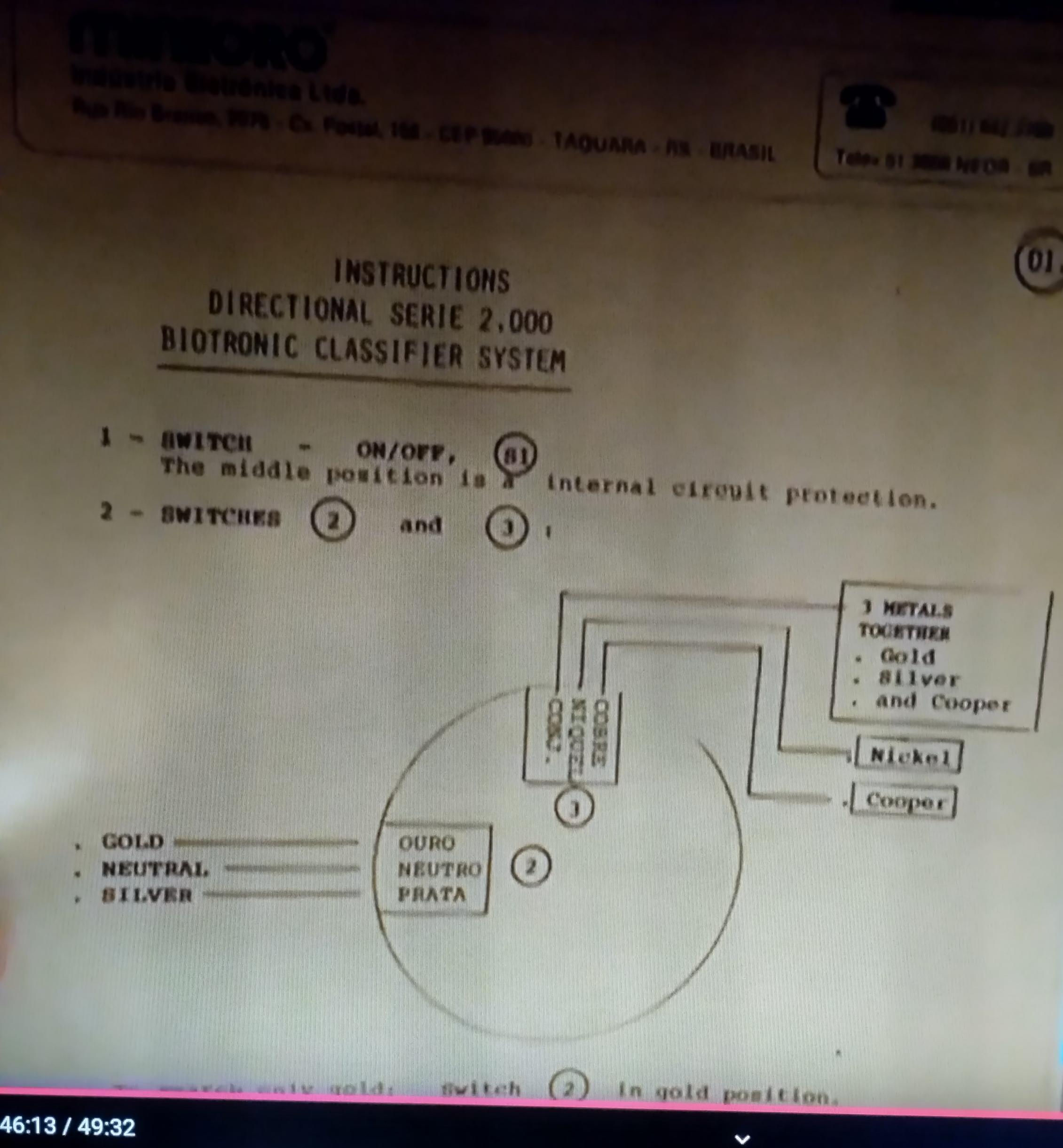

            • #66
              Are the two switches on the head of the dch 85 the samples?
              • #67
                It seems like it is .Inside the coils are metal samples, something like filters. But the size, number of turns, and weight of the samples are still a mystery.If you have such information and have the opportunity to share it here with the forum participants.
                • #68
                  I don't have the information about the samples, I'm still looking for information. (Are the samples in wire form? Or is it the core for small copper coils?) Surely some people know, but the question is whether they will provide information. Until then, I'm continuing my construction with the data I have and I'll see in the hunt..if it can receive the signal I get with another LRL, it's enough for me for now.
