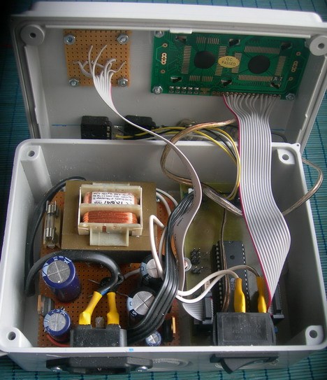

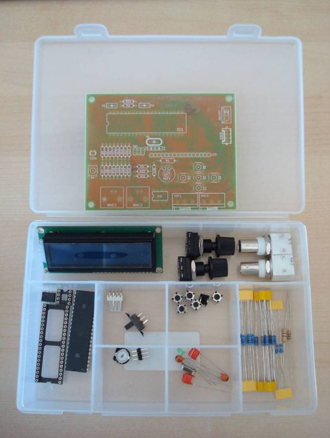

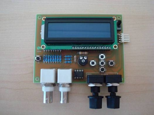

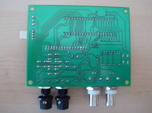

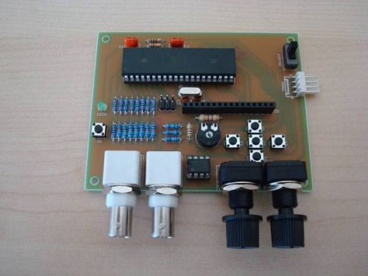

  • AVR DDS signal generator V2.0
    http://www.electronics-lab.com/proje...ion-generator/
    http://www.scienceprog.com/avr-dds-s...generator-v20/
    Main AVR DDS V2.0 signal generator features:
    Simple circuit with easily accessible and cheap components;
    Single sided PCB;
    In box power supply with external AC plug;
    Dedicated high speed (HS) signal output up to 8MHz;
    DDS signal with variable amplitude and offset;
    DDS signals: sine, square, saw, rev saw, triangle, ECG and noise.
    2×16 LCD menu;
    Intuitive 5 button keypad.
    Frequency adjusting steps: 1, 10, 100, 1000, 10000Hz;
    Restoring last configuration after power up.
    • AVR DDS signal generator V2.0 Source
      source code
      EagleCAD schematic and PCB
      Proteus simulation files
