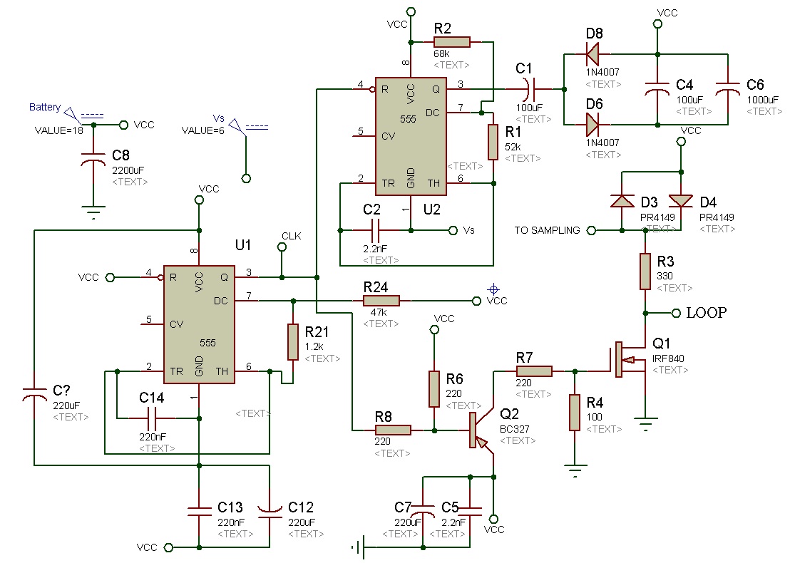

    Hi guys
    I simulated the output of my "Luminous 15000 metal detector"
    but I am a little bit confused of output waveforms.
    my detector is a "PI detector" and it doesn't work and I wana fix it...
    "IRF840" is on just for 200usec
    Does it mean that my LOOP just search for only 200usec
    What I expected to see was that "IRF840" be on for (1-td)
    but now it's on for td=200usec
    and approximately how much current according to ICs is going to coil(=LOOP)?
    Please explain how this part works...
    Thanks

      kazem2114 - The best place to post your questions is at http://www.geotech1.com/forums/index.php
      Go to the Tech Forum and start a new thread there.
      The LRL Forums are for ... well ... LRLs (what else?), not conventional PI detectors.
