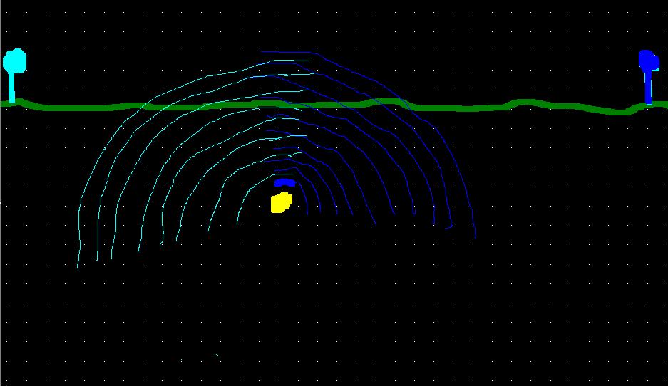

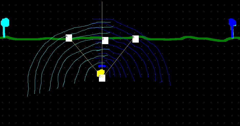

      in pics I tried to show dept determination of ulf .this is my idea but logical.
      there are lots of stations on earth.each have different frequencies this is why we ne broad band reciever .
      each color in pic represents different station and frequency.
      according to drawings
      angle CAO = angle CBO ,say X degree to this angle
      our selonoid winding(antenna) also has recieveing angle which is equal to 2X degree
      so
      we measure the lenght between A and B ,= L
      then divide 2 = L/2,
      sin(X) / cos(X)= TAN (X) =dept of target / (L/2)

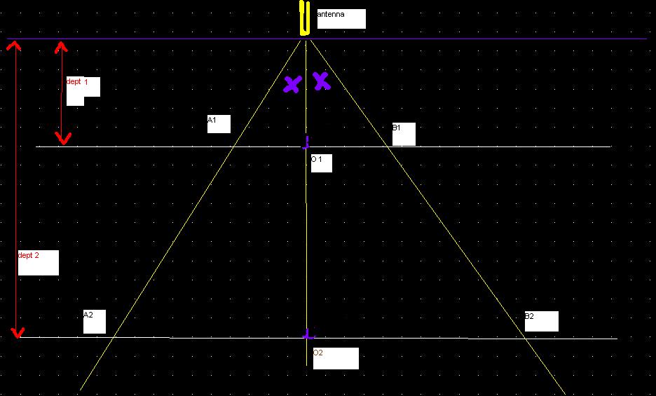

      • #18
        while you look at this pic,think that the path you are walking on is sank to the level of target and think A,B,O at that level.it will be easy to understand my thoughts
        thanks for yur interest

          I can not understand you want to narrow angle.
          if we want to increase dept,it is related to power of base stations.and can not help in this manner.
          but willl effect dept measurement badly.
          because our user wil be a man and wont have constant walking speed.if he walks for long we can say approximately something.but in short distances it will be problem and this could occur when you decrese angle.
          because chip will count time between start and end of signal .than uses this to have approximate L . than calculate dept.
          so we can not decrease angle much.
          since decreaseing angle does not have adventage on dept penetration.In my opinion no need to do this
          thanks
