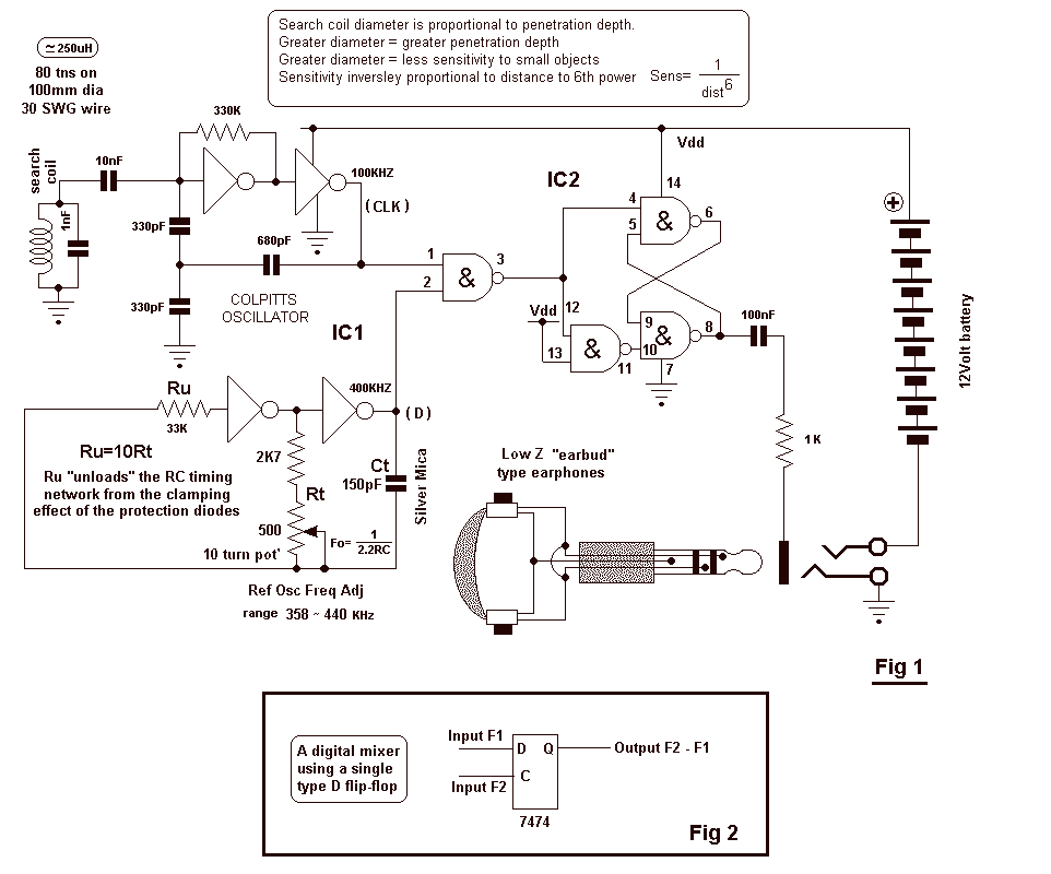

                          thanks geo.
                          I have a nice schematic like this and you will like it. Frequency controlled. Between 15khz and 36khz.
                          I published some of it.
                          • hello geo
                            Can we adapt this logic in dc2008 to this circuit?
                            • No, this is a simple BFO and has nothing to do with the first stage of Mineoro or with the working principle of a lrl..
