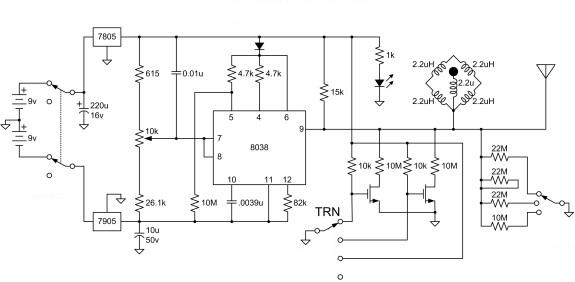

      ok i know but :
      What is the basis of this circuit?
      The circuit generates a frequency vlf.And is produced by victor track.trn
      The system makes use of a telescoping antenna vlf waves.If you can explain about this circuit

                hi j-p
                I want to send vlf waves to a radius 100 meters or 200 meters with telescopic antenna.
                Please give me a guide or schematic

                  Hi ma330,
                  This circuit cannot make a A vlf broadcast to 100 or 200 meters from using a telescopic antenna.
                  But you can test with a telescopic antenna to see for yourself that it does not send a vlf signal to 100 or 200 meters.
                  A coil antenna can send VLF more than 100 meters from this transmitter.
                  For 100 meter radius, you need a long length of wire, 640 meters length.
                  Then make a mark on the ground of 100 meter radius where you want to broadcast.
                  Then you must put the 640 meters of wire on the ground -- put this wire in a single loop on the ground to follow on the 100 meter radius you marked on the ground.
                  After the 100 meter radius wire is put on the ground, then connect one end of the wire to the antenna connection of your circuit board, and connect the other end of the wire to the ground connection.
                  This is exactly how a geologist connects to broadcast vlf to a 100 or 200 meter radius, or even more radius.
                  After the transmitter is connected, and it is broadcasting vlf in 100 meter radius, the geologist will take his small vlf loop receiver in his hand to search for buried things inside the 100 meter radius.
                  He can mark different rocks, water, and even metals he finds from using his vlf loop receiver.
                  Then the geologist can make a map to show things he finds buried under the ground.
                  If the geologist was not a geologist, but was a treasure hunter instead, then he would call this map a treasure map.
                  If you want to use a straight antenna, there is one way a straight antenna can be used to broadcast vlf to a large radius.
                  But maybe the straight antenna is bigger than a telescopic antenna, and maybe you need more than one straight antenna connected together.
                  See alternate method for straight vlf antennas here: https://en.wikipedia.org/wiki/VLF_Transmitter_Cutler
                  You will find diagrams and photos on the right side of the page to show how these straight aerial antennas are used.

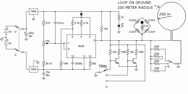

                      Hi ma330,
                      There are many easy vlf transmitters posted in this forum including a transmitter with 8038.
                      If you want to use this circuit that you posted above to transmit in a 200 meter radius, then
                      you can use the circuit below.
                      I did not test it, but it should work.
                      You can test to see if you are getting VLF in the 200 m radius by using a small VLF loop receiver tuned to the frequency you are transmitting.
                      Hold the receiver loop horizontal, then walk around inside the 200 meter radius to see how strong the transmitter signal is at different locations.

                          Hi ma330,
                          WM6 is correct.
                          A telescopic antenna is not good for sending VLF waves.
                          Another circuit which is more simple for 8038 transmitter is this:
                          Connect the 200 meter wire loop to the (+) and (-) on the right side of the diagram.
                          This is a low-power circuit.
                          You can send more power if you add an amplifier before connecting the wire for 200 meter radius.
                          You can try this circuit:
                          Do not use the ground probes at the right side of this circuit.
                          Connect the 200 meter radius wire to the two connectors for ground probes.

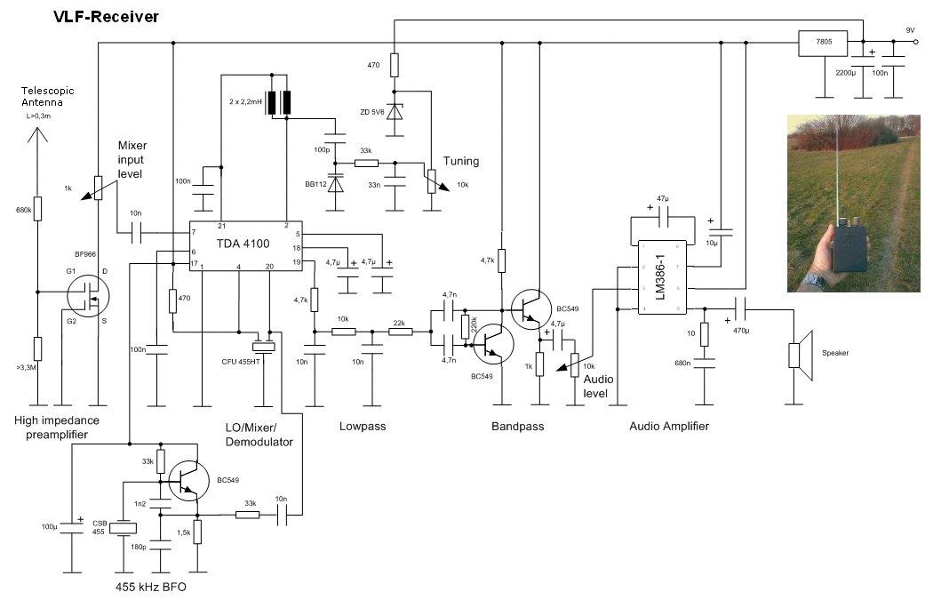

                            Hi ma330,
                            I believe that a coil antenna is best to receive VLF waves and to transmit VLF waves from a portable transmitter or receiver.
                            But it is possible to use a telescoping antenna for a VLF receiver.
                            I found a project online to build a small VLF receiver that can tune VLF signals, based on the TDA4100 IC.
                            This IC has a mixer, VFO, IF amplifier and demodulator unit in one integrated circuit, so there are not too many other parts to add.
                            This circuit uses all inexpensive parts. And the article tells some substitute parts you can use if the parts are not available.
                            I do not recommend to use this method for treasure hunting because I do not think you will find any treasure with it.
                            This project also requires a knowledge of electronics and receivers because there are many options shown in the project.
                            I cannot give you advice for the best way to build this circuit, but you can look at the article for tips from the person who designed it.
                            If you want to receive VLF with a telescopic antenna, then this method is working.
                            See the full article here: http://www.vlf.it/fritz/pocketrx.html
