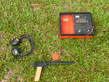

    Hi to everybody, specially to those who are knowledgeable to vlf theories and its application. I have build the gold gun and i have heard that the vlf transmitter where it is tuned to is no longer transmitting vlf signal. So, i used my Gemini III (transmitter) as local transmitter. It transmit 81.92 khz according to the manual. I tuned my gold gun to the same frequency. I am not sure if its transmitter can be used in conjunction with the gold gun. So I ask somebody in this forum to help me the correct procedure in doing the search.
    The Gemini has a ground assembly an option in locating a buried pipe with known point. So i use this option via a stainless rod inserting into the ground to transmit the signal. I do not know if i am right on this set-up. So, here are my questions:

        Thank you for your good suggestion WM6. I know that you are very knowledgeable in vlf topic. Actually i am looking for Big and not small objects like coins or gold nuggets. I have Gemini III so it came to my mind to try to use its transmitter as local oscillator. I did pick up the signal from my built gold gun but only 3 meters and when i inject the signal into the ground via a ground rod connected to the ground assembly, the gold gun will not sense the signal. So please give me idea what is the correct method of searching using gemini transmitter and gold gun as receiver. Will the gold gun null if it detects a reflected signal from buried object or will its output increase if it also detects a buried object? Sorry for many questions that i asked, i am still studying on this type of method. Thank you..

                          I have tried the idea of reflective detection using Gemini III Tx with my home made gold gun But i cannot determine if i have the reflective signal. It needs more experimenting...
                          I used Magnacast type detecting reflective signal for the test but again no result yet.

                              The power of Gemini is very low for creating a secondary magnetic field from buried targets.
